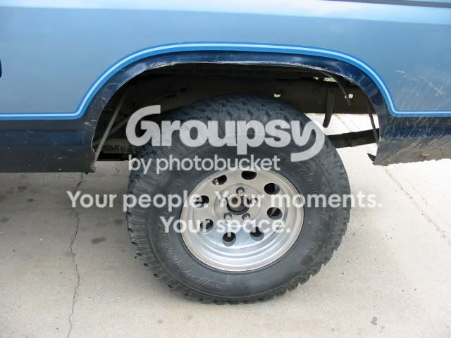

hey boggin, heres how i did mine
i followed the pinstripe.
tools i recommended
Tape (masking or duct)
Grinder
Hand sheet metal snips
Air Sheers
Self tapping screws
something to hold wires up out of the way
Air saw or Sawzall
I had to trim the splash shield on the front and rear, it took me about 2 hours while takeing my time. i still have to clean them up a bit and i need to get some rubber to put over the edges.
more pics
i also trimmed my bumper on the front cuz it would rub the tires a little
