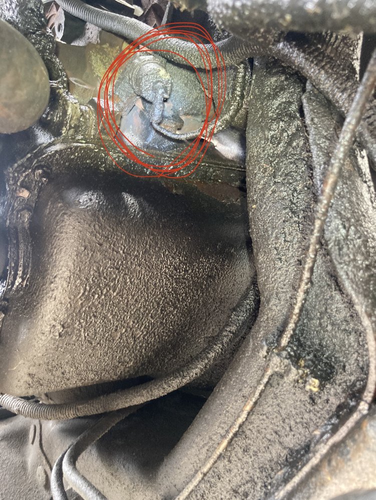

Is this my oil pressure sending unit/switch? This is on drivers side.
Any pointers as to what the threading is? I assume I’ll need to quick swap the test gauge connector on so as to avoid losing lots of oil quickly.
I‘m considering just leaving a test gauge hooked up temporarily and running a line to the cab so I can watch it and note symptoms. Maybe it’s a risk of oil busting out in cab but it’d be worth the risk to learn something accurate here.
And I’m just assuming I’m about to find out that the engine needs to be rebuilt.
Yes thats the sender.
Im not sure on thread size...but if you buy a sunpro kit for a mechanical gauge i believe they come with different fittings.
