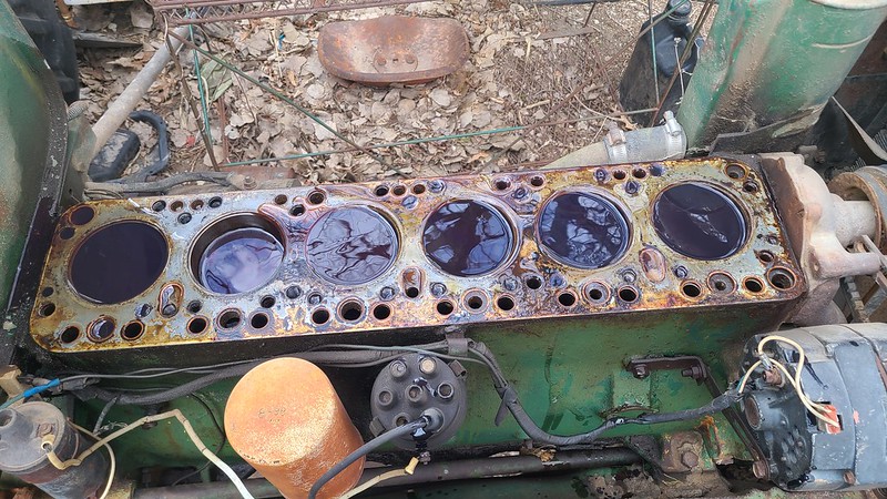

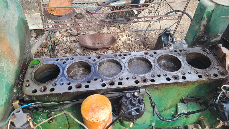

Ripped the head off to look for carnage:

Got all the pretty red hydraulic oil out... and everything looked fine.
Farm and Garden

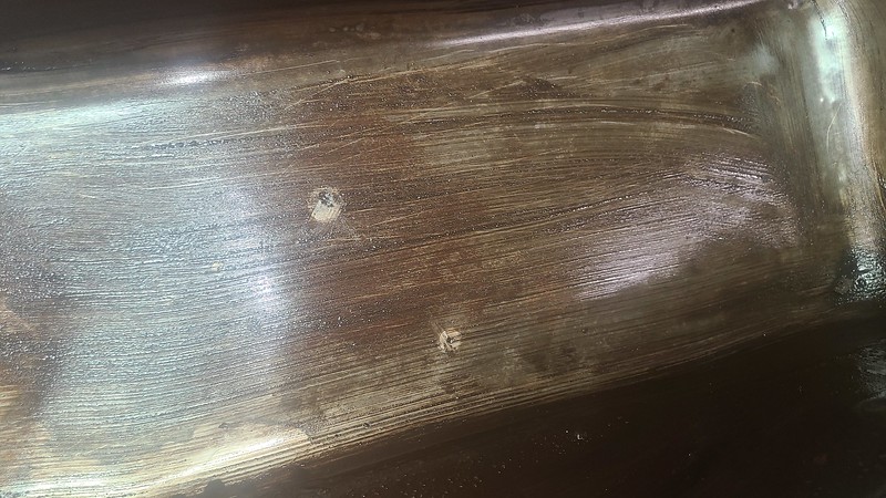

Nothing obviously broken/cracked. Pistons are all even with their mates so no bent/broken rods. #5 was lower on fluid so either it soaked past the rings over the winter or maybe it has an issue.

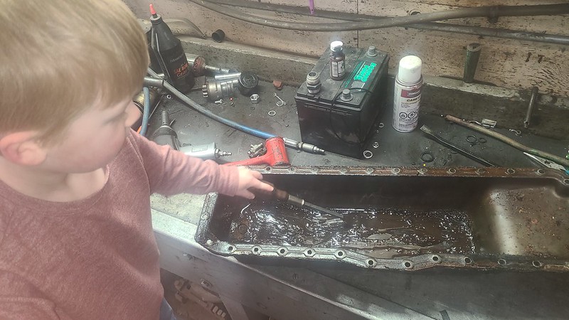

So I dropped the pan which I later learned wasn't really intended to be done with the engine in the tractor. When to drop the oil and who knows what all out... and it was empty. Didn't remember doing that before but maybe I had? Major PITA. Front pan bolts are over the front axle bolster, rear two are inside the rear inspection cover in the clutch bellhousing. So remove the expansion cover... but you can't get a wrench on the nuts. I wedged a flat screwdriver in there to hold them until they got enough loose enough to get a wrench on them. Once all the bolts are out the cover is trapped between the clutch housing and frame but I could send a socket up there with a long extension to zip out the oil pan bolts. Even with the pan out the cover is still trapped in there... I don't really get the point of an inspection cover if you have to pull the engine/clutch to do any inspecting.

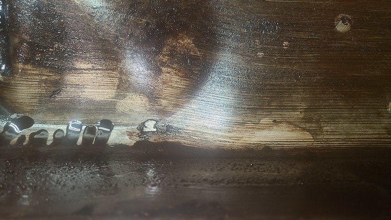

Anyway, I didn't get any pics but same story down below. No smoking gun. I can't see anything damaged.
I am thinking hone the cylinders to get them nice and clean and pull it around and exercise it. It is still really tight and there is some corrosion where the pistons were... maybe the "pop" was the pistons moving past that?
So I go to clean the oil pan up so I can put it back in and put some kind of lube in there.

Fudge, a rust hole.

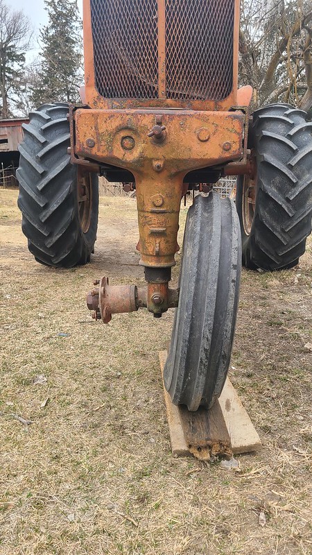

Getting tired of that thing kicking my butt I decided to replace the front tire on the WD so I may have at least one functioning tractor this spring (granted it needs brakes)
Who says you can't get a solid axle to flex like an independent?

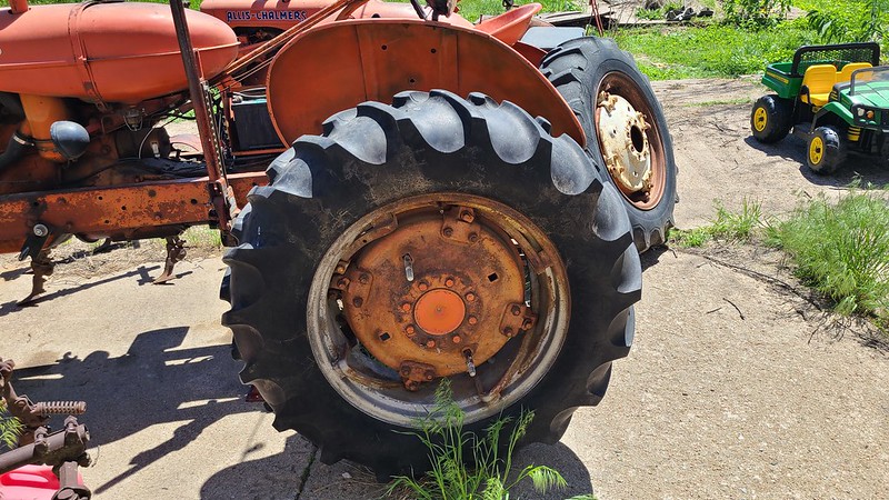

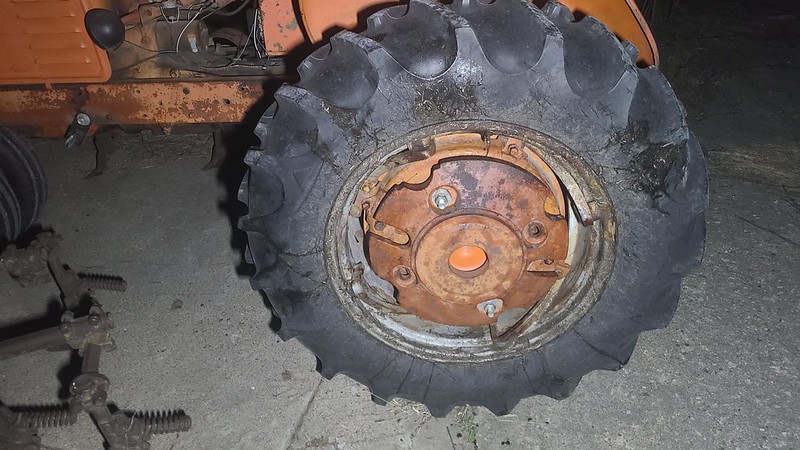

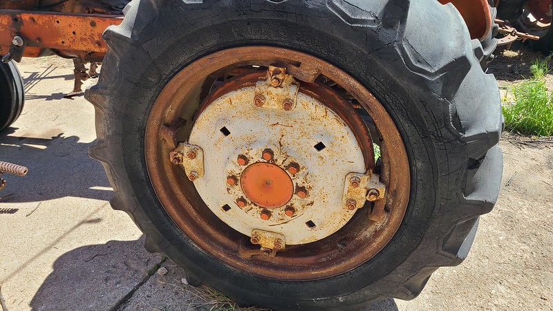

I say that because my main tractor, is having serious rear wheel problems. The new valvestem is puking fluid out:
Farm and Garden
Tire isn't new, it has some weatherchecking... and it seems to be oozing fluid out the cracks which I don't think is a very good omen.
Farm and Garden

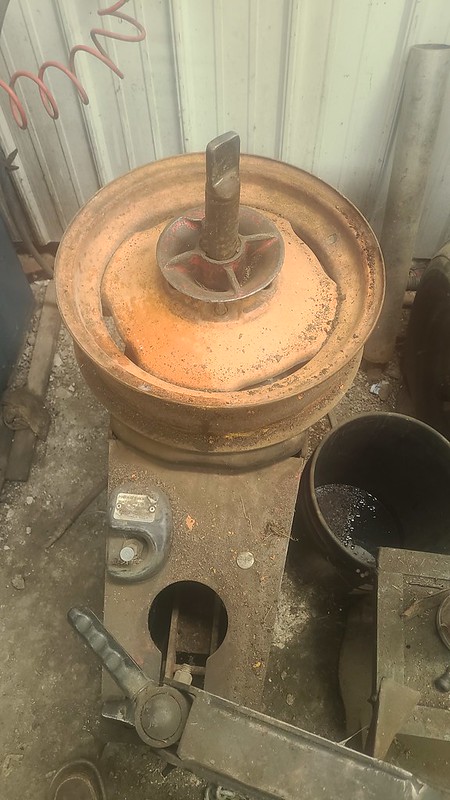

Sooo... it spent all winter on a jackstand and I haven't quite figured out how to crack that nut. I have a better tire... also on a fluid laden rim. So breaking down two wheels full of fluid, cleaning up a rim and reassembling with a new tube. Just haven't achieved that level of free time/ambition yet.

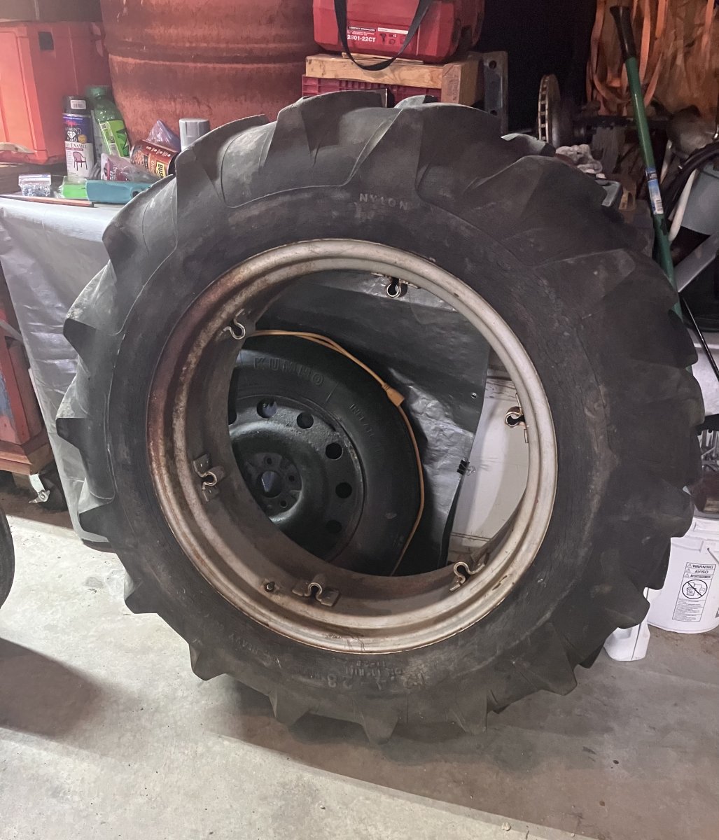

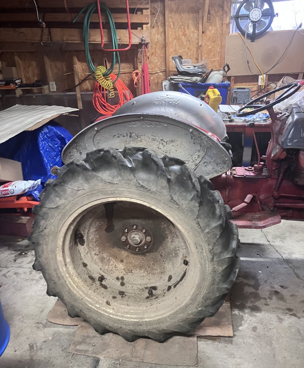

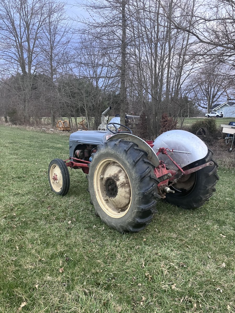

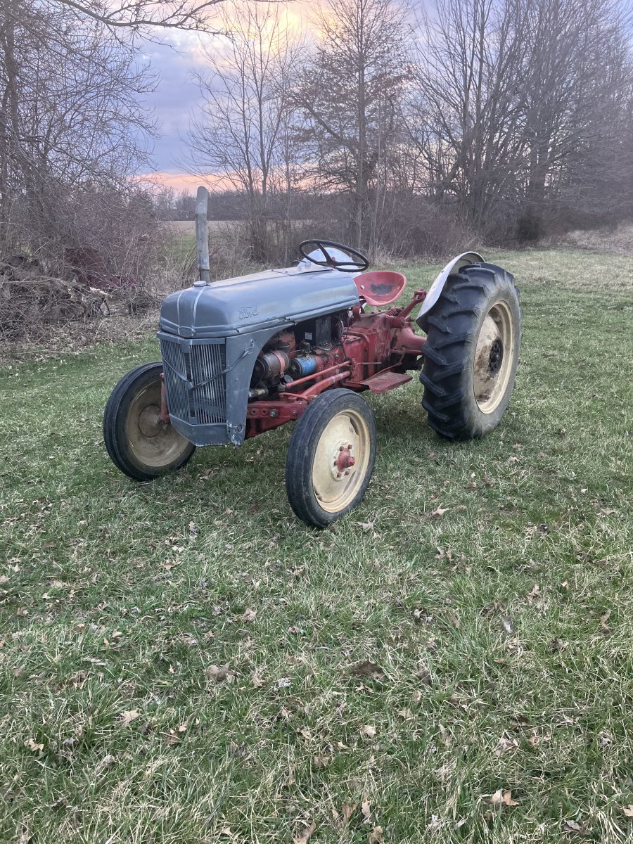

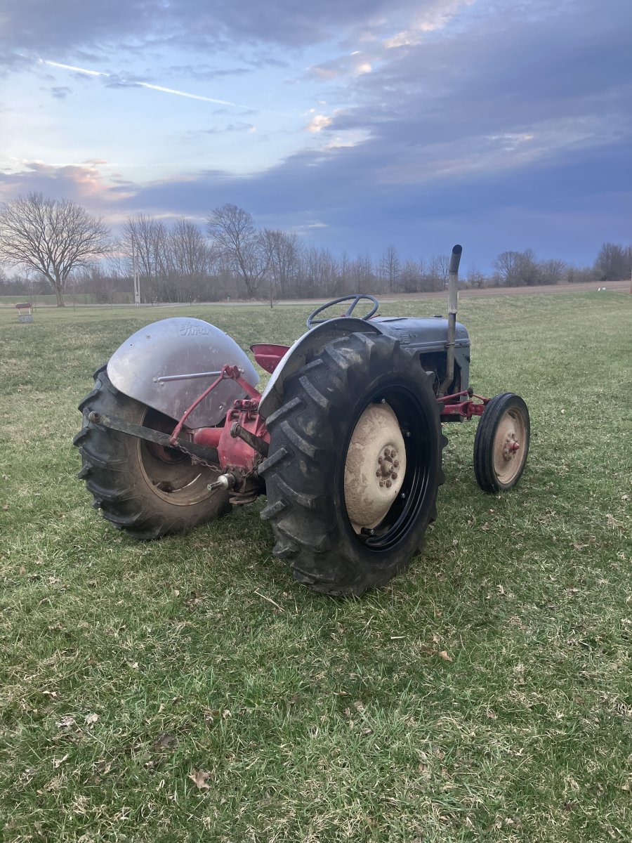

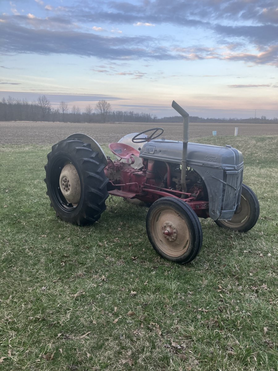

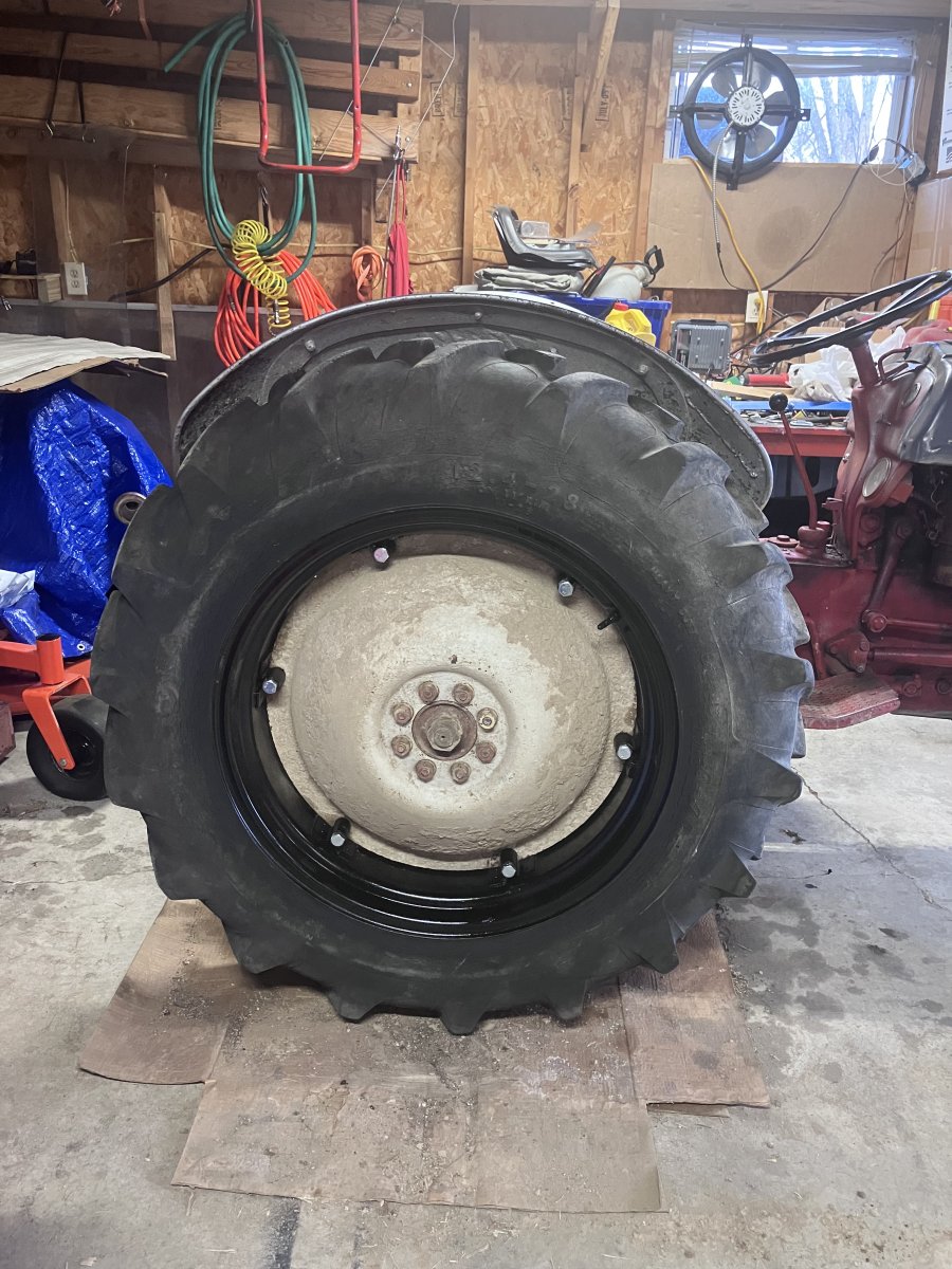

I started to work on the 8N tonight. Got the “new” 12.4 tire ready to go on so started to remove the right side tire thats a 11.4 , someone definitely used air tools. Had to put a 3’ pipe on my 4’ breaker bar to get the lugs loose. Flipped the tire assembly around so I can get to the hardware holding the center disk in that needs to be put in the rim/tire I bought. Found the original tire has fluid in it. Very heavy, not sure if tire on other side is fluid filled or not. Soaked the nuts with wd-40 but may have to cut them off with the angle grinder/cut off wheel like I had to with the wheel I bought, it had a 2N center in it.
Farm and Garden
Farm and Garden
Got the tire swapped out, looks better with the same size on both sides. As far as I can tell the other tire wasn’t loaded. Took it out for a ride. Doesn’t look the greatest but runs & sounds quite well. Painted the “new” rim black, mostly because I dont have to mask off the tire, silver or white would really show the overspray.

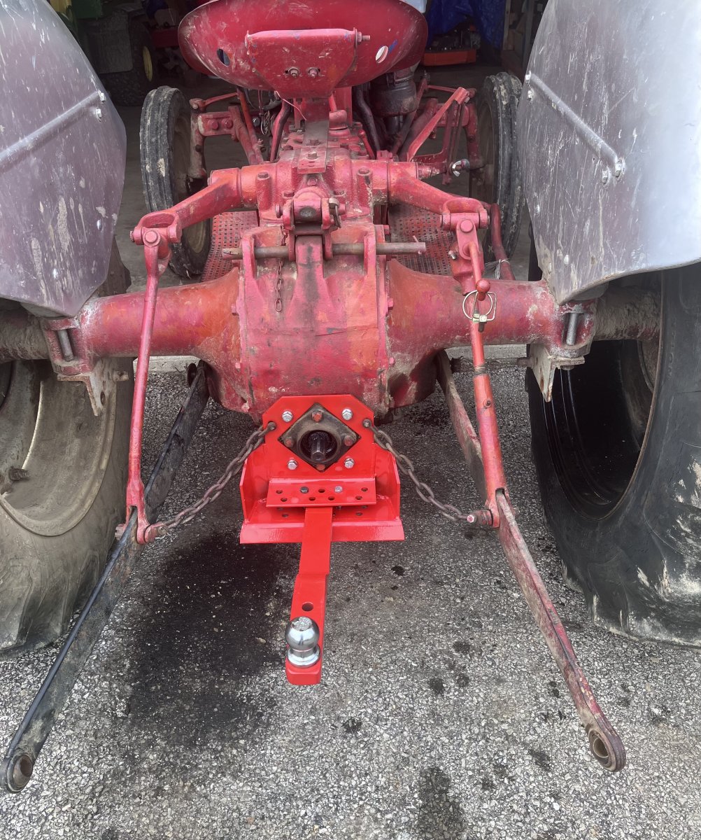

changed engine oil & put the drawbar kit on today, yesterday I put the old 11.2/28 tire up for sale & someone drove from the indiana border to buy it. Now I can order a alternator kit. The generator on it now is only acts as a idler pulley for the water pump.

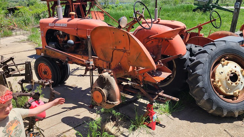

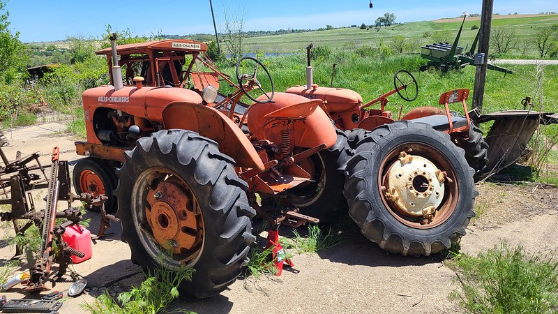

About a year ago I swapped a wheel that came with my WD onto my WD-45. It worked great all summer but after I finished chopping stalked it started leaking fluid around the valvestem. Overnight it was half flat and leaking bad so I sneaked it over to concrete, jacked it up and stuck a jackstand under it. And there it sat.
Now it is tis the season to plant and my main horse is still laid up.
The WD would do it... but currently doesn't have brakes.
The B JD could maybe do it if the hydraulics would do it. A lot of things changed in JD land between 1946 and the 1970s though.
The C doesn't have hydraulics
The Oliver is still a lawn ornament and doesn't have hydraulics.
Dad offered just borrowing a wheel off of one of his tractors just to plant with... so sure. As a side perk... no fluid so it is much easier to handle.

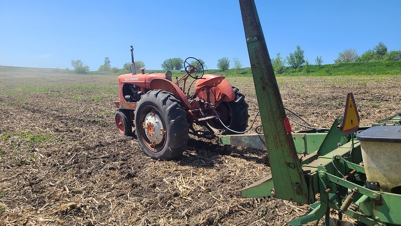

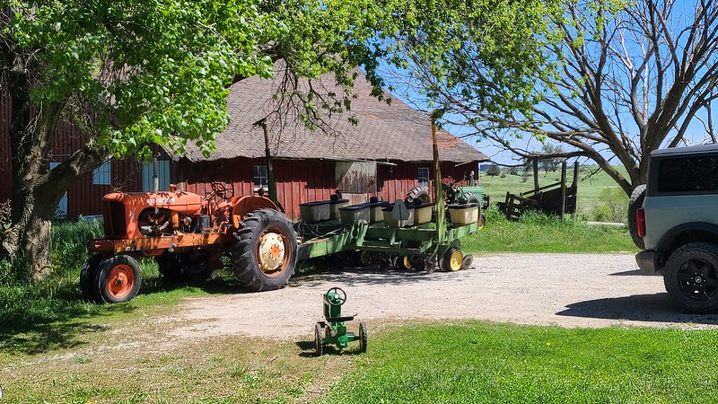

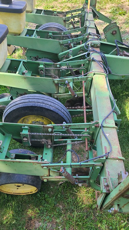

Hooked up the planter, sneaked it under a shade tree and popped the seedboxes off to swap the corn meters for the Kinze bean units to plant soybeans.
Farm and Garden
Farm and Garden
Farm and Garden
Farm and Garden
Nothing to it... got everything all greased and oiled to hopefully ward off evil spirits.
Farm and Garden
And we beat the rain and got all done.
Farm and Garden
I am not a farmer, but is that what you would call "no-till?"
Kind of.
I hit it with the disk once. Makes life easier on the planter, helps the ground absorb water better and kinda resets weeds to save a round of chemicals.
