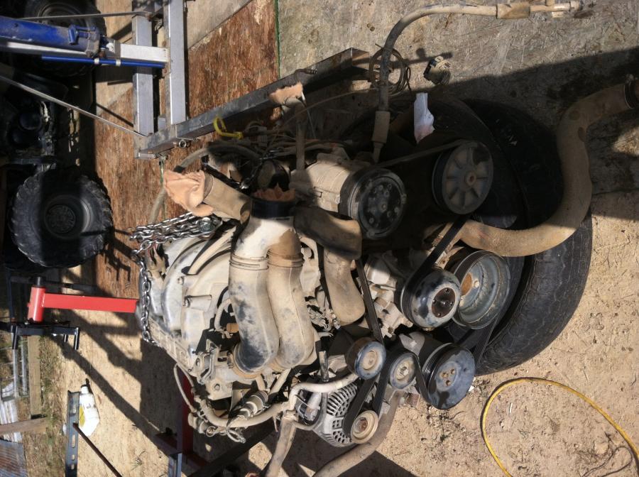

302 donor motor.
Just gota strip efi junk and get my carb stuff on.
Manifolds frm a 77 f100.
Im gonna try the original oil pan since its rear sump
Distributer pending on cam wil be either for an 84 or 85 mustang gt and a gm module for fire. Round here u cnt find wiring harness for duraspark 11,to many race car fans.
Radiator frm james duff
Il be buying the oil relocation set that swivels frm canton racing
Im using stock carb for now.but want to go with holley truck avenger carb.
M5do-r2 trans frm 97 f150
Clutch pressure plate throwoutbearing and starter frm 96 f150
Flywheel or ring gear is still not known for this tranny.any help id appreciate.
Advance adapter for t/case to trans.
So far thats what i gathered i needed and my build started wed
