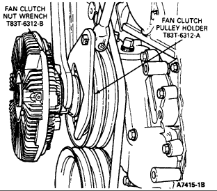

what holds the fan clutch on a 2.9? i have the bolts out of the pulley. thought that held the clutch but it doesn't. saving it is not important; i am yanking a 79 motor to save for rebuilding for my 88. bought the truck just to get the later heads

Also, the 2.9 fan clutch uses left-handed threads, so turning it to the left will tighten it, turning to the right will loosen.
I originally posted you could use an air chisel but edited my post because if you've never done it before you can destroy the water pump doing it that way... was trying to give the "safe" method. You can rent the wrench/pulley holder at advance or autozone for free.
looking at the diagram, it looks like i will need to put the bolts back in the pulley to use that tool. will try to get a loaner from one of the local parts stores, use it and duplicate it (the square hole for the 1/2 inch drive will be the hardest part) and return it
Yes, pulley needs to be reattached. You hold the pulley with one tool and turn the nut with the other. Like adsm said, reverse thread. I "think" its 36mm for the nut? But im not a 2.9 guy...
The other method, you still reattach the pulley, put the belt on as tight as you can, and then use an air hammer or a hammer and chisel and litteraly just wack at the edge of the nut to break it loose. I have broken a water pump shaft doing it this way though but eh... and if your gonna replace the water pump anyway. Go for it.

If you can find a wrench (usually adjustable or the pipe wrench above) to fit the nut, you can find a flat piece of metal and drill a hole in one end that a pulley bolt will fit through. Undo one of the pulley bolts and bolt this flat piece of metal to the pulley and then let it swivel around till it hits something and stops, and then use the wrench you found to loosen the nut. Usually you have to hit the wrench with a hammer to break it loose. And after all that, if it's left hand thread don't forget to go the wrong way. I have spent 20 minutes trying to get a fan back on only to realize I was turning it the correct way, you have to turn it backwards with a lefthand thread. What a dummy.
The hammer/chisel method works but when you can rent the correct tool, why would you risk damaging the water pump? Speaking from experience, fan clutches are also quite a bit harder to remove once you've got that nut all buggered up with a chisel too.
When I did the fan clutch in my Bronco 2, if I recall I used a crescent wrench with a cheater pipe on it, let it rest on the frame, and pulled the coil wire off and hit the starter for a second...came loose really easily that way. Just make sure you put the wrench handle/cheater pipe on the right side, otherwise you'll just tighten the nut up more. Yep left handed thread so it unscrews to the right instead, confuses the crap out of a lot of people though LOL.
