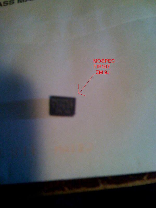

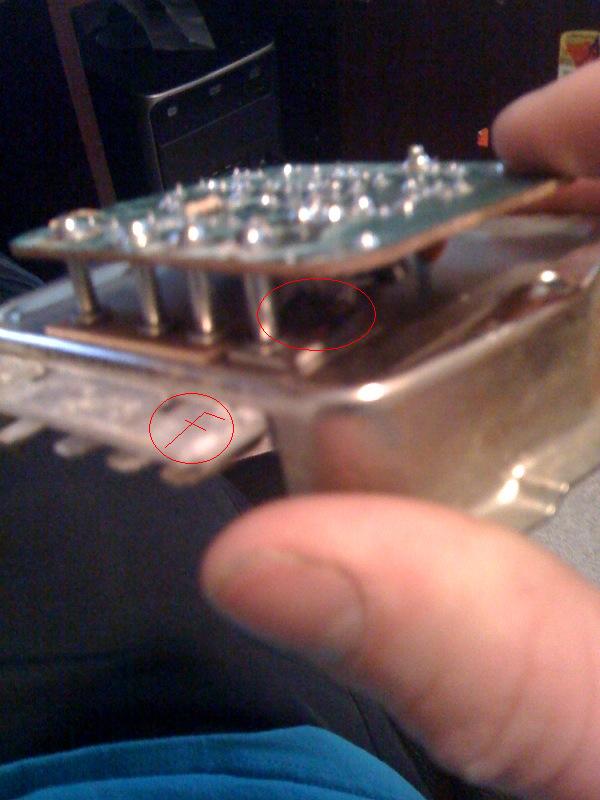

hello i have been having charging system problems and i have since removed my EVR to find a rattling. When i opened the evr i had found a semi conductor had been broken off in two pieces, one of the pieces was still mounted to the base casing of the evr which led into a prong labeled "F".
is this enough damage to cause the evr to malfunction. Attached are 2 photos. Thank you for viewing

The "F" terminal is an important one. No charging without it. Go buy a new regulator, they are about $12
