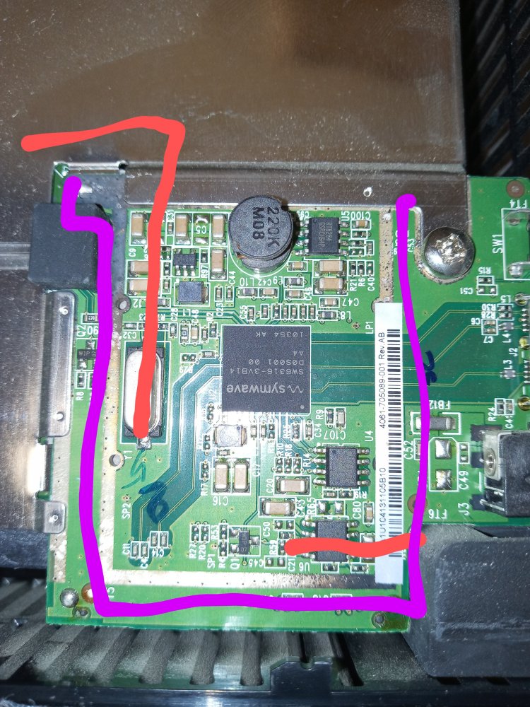

So I opened it up. First thing I noticed was the silver square, marked with purple, had some burnt areas, marked in red. I assume this is my problem. Getting too hot and failing after a few minutes of use.
Any suggestions or is it toast?

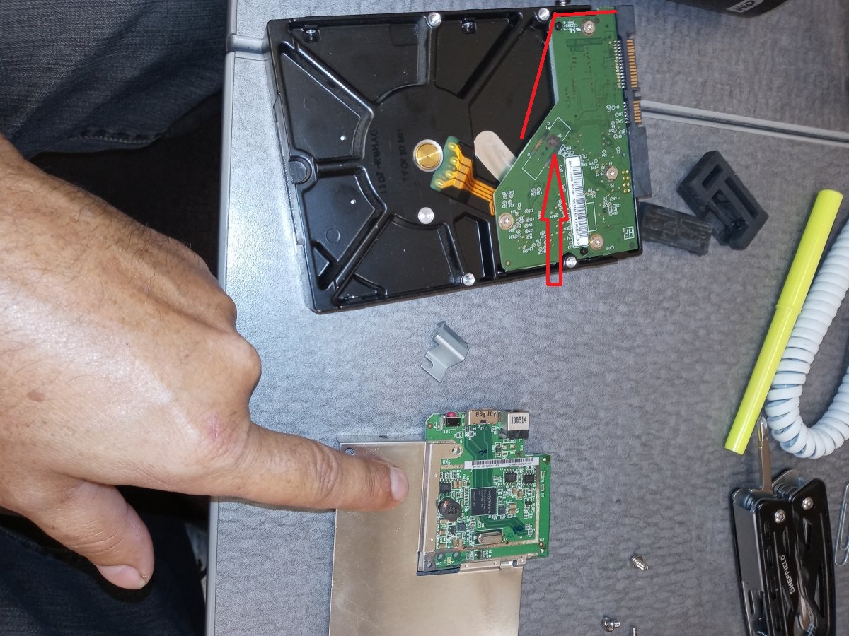

I'm having trouble orienting myself in that picture - is the photo of a board from the enclosure or the actual controller on the back of the drive?
65616
That small board is the one pictured earlier. It's the first thing you see after cover is removed.

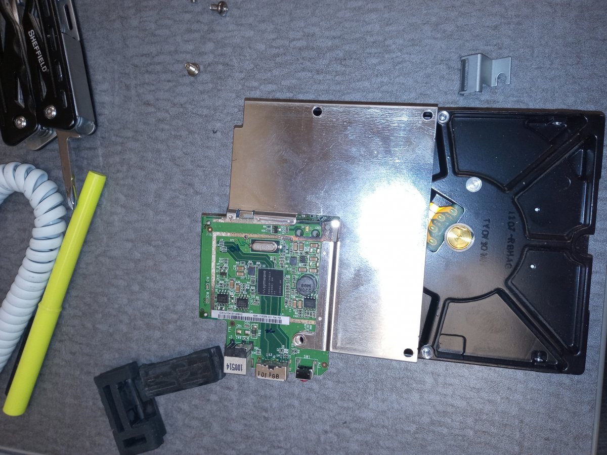

Remove that plate and there is another board under that one. I was able to clean it up. There was carbon build up lol on some places. I know the black stuff is "smoke trails" and it's probably toast, but I'm going to out it all back together and hope for the best.
65621
From my RED arrow and up, all those black dots should be copper colored. Hopefully my little cleaning will help.
Okay cool - that board is not part of the hard drive itself. You can pick up an adapter to connect to the drive over USB, or if you have a desktop PC you can attach the drive directly using SATA and power connectors inside it.
