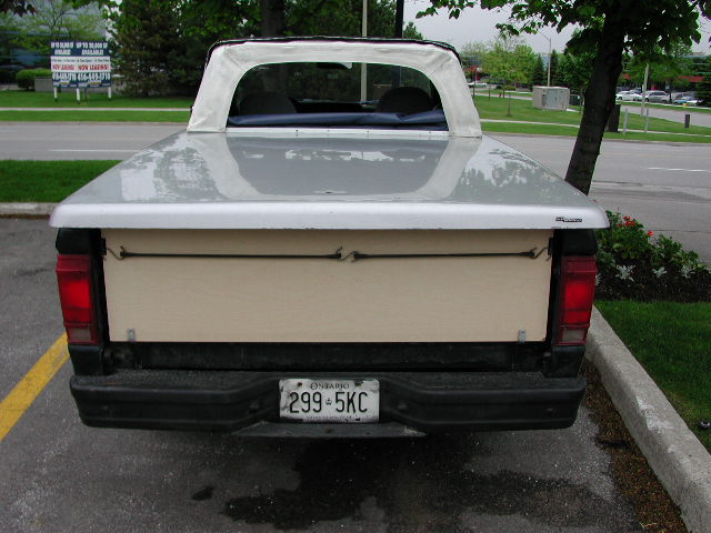

I liked my short frame too...but the regular cab is not big enough for me so I tried other options...like removing the back wall...I actually have pics of that somewhere...and put a convertible top on the back end...it was nice in the summer...but I have no bum now because I froze it off driving that in the winter...too much space to heat in a Canadian -30* Winter...
Here are some pics...don't laugh...I'm sensitive about this period of my life...lol!

I have to admit, I chuckled at the pics, but only because I have considered similar things in my time. Like to idea of boxing in the back of my 85 Toyota 4Runner to make a 2-door, pickup sorta thing. It was a cool idea, just never came out the way I expected or intended. Call it being young and dumb.
