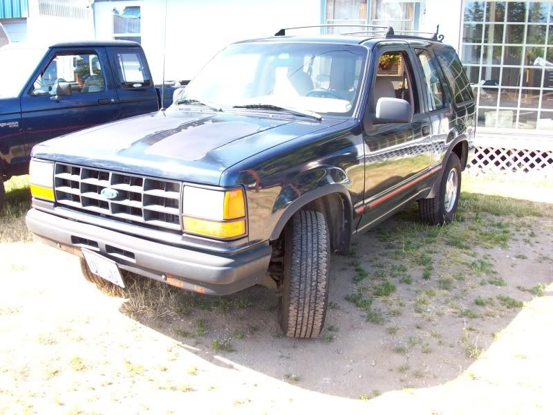

Formerly known as the Mommy Missile it was bought and purchased by me. I figure i'd make my own thread now since its finally in my name. I drove it up from battle ground and she rode like a champ, just a little shimmying at about 75 mph cause the front swaybar is disconnected and I replaced the taillights in chehalis cause I started seeing a bunch of highway patrol. here's a few pics from the day after I got home:

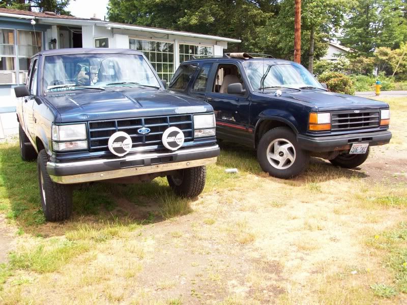

next to my truck
dents :thumbdwn:(I put the navajo tails on it at a wal mart about half way home, one of the og's was broken):

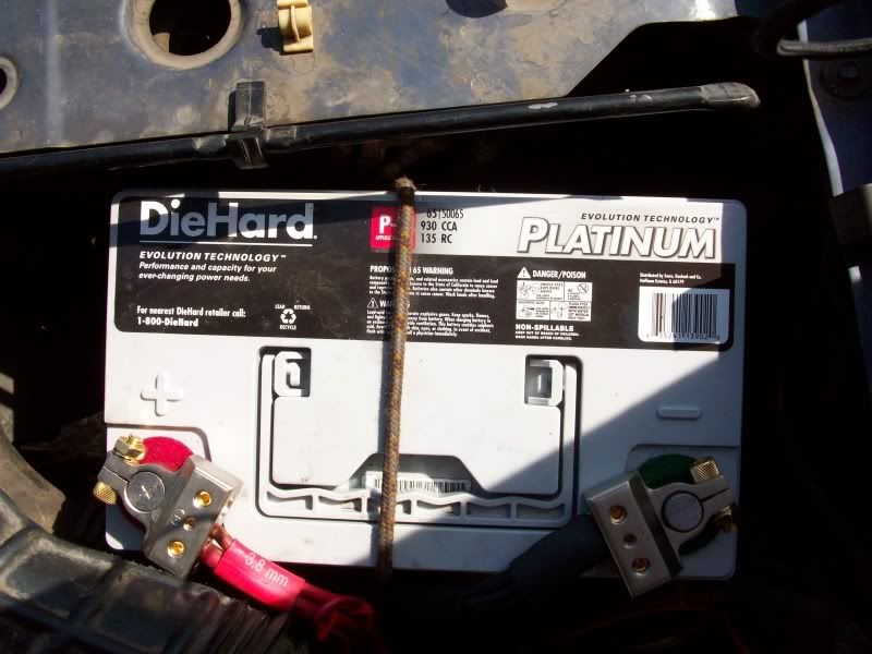

I finally cleared out all the unneeded and horribly done wiring for the lights and cb. I also replaced both battery terminals with a set of boss audio terminals and bought a "poor man's odyssey", a sears die hard platinum battery.
