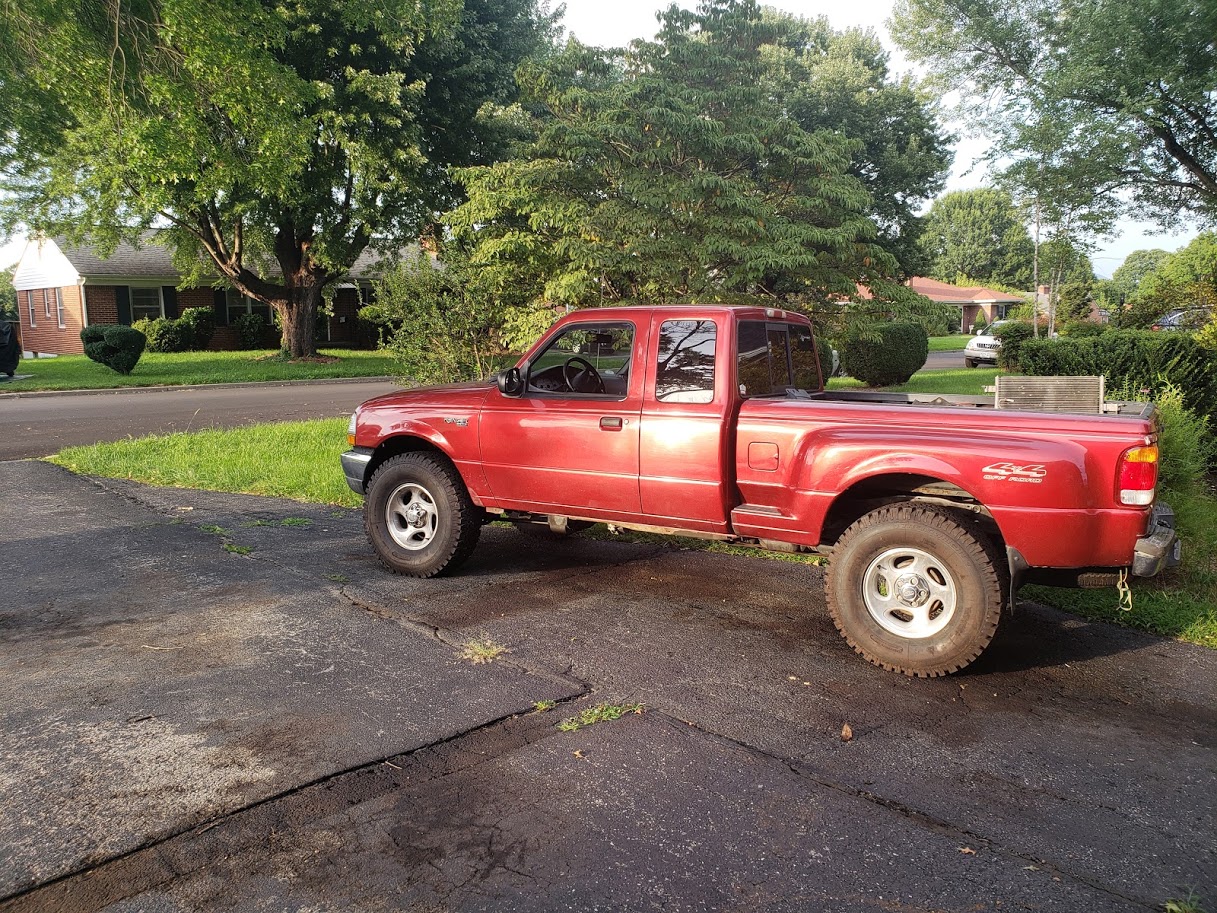

I used to have explorer leaves in my truck. They raised the rear enough to remove the factory blocks but maintain the stock ride height
With the factory leaves and blocks
With just the explorer leaves

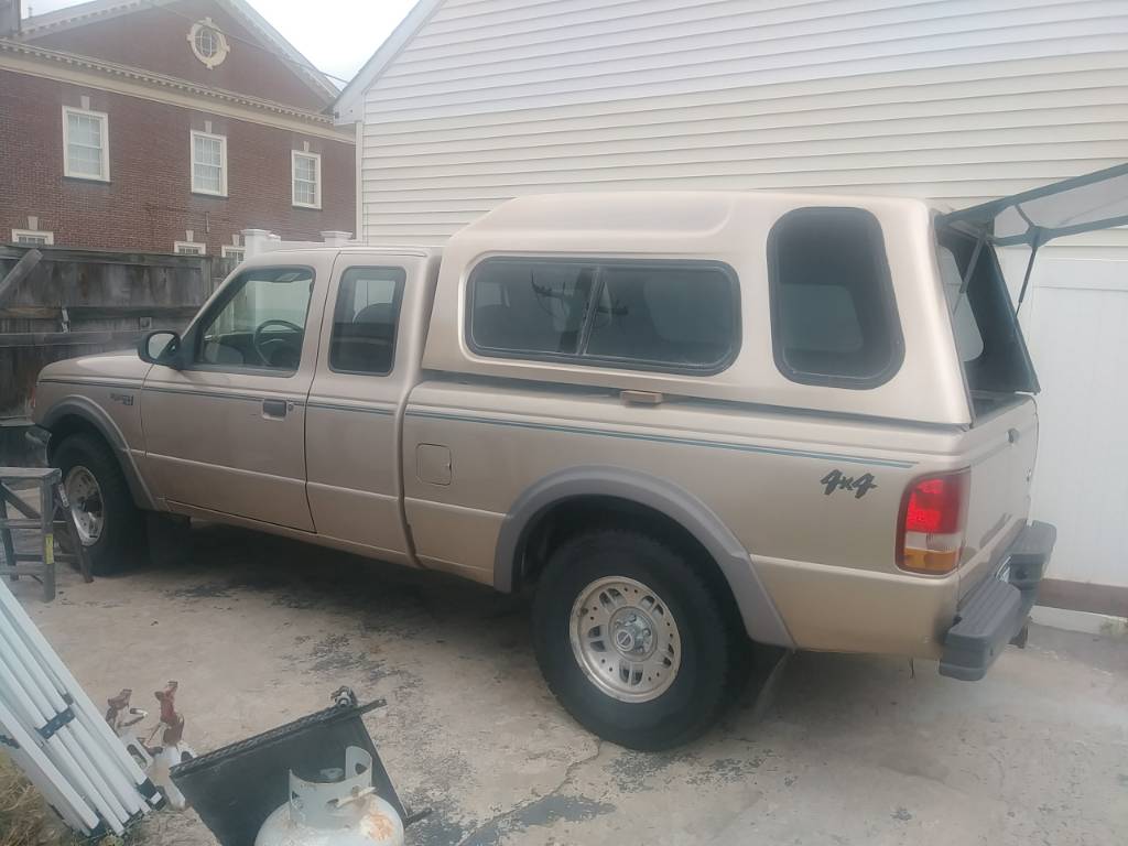

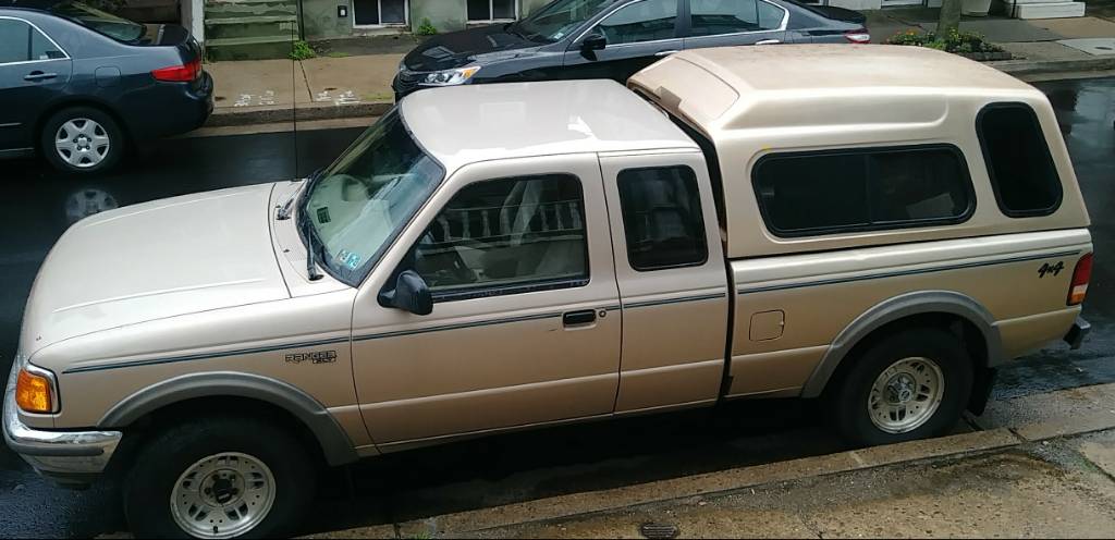

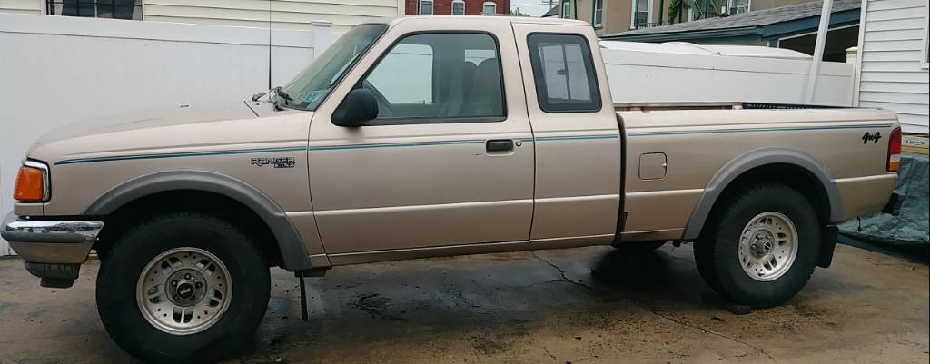

Well this is how my truck sits now, as you can see it's almost exactly level There are blocks under the rear springs, there is nothing under the front springs.
I think the front Springs are just about done with life because the camber bushings are almost maxed out.
That truck looks really good for the age. By the way, YOU LIVE NEXT TO EVERYONE. Sorry, I live on 20 acres and am not used to seeing all those houses next to each other.
