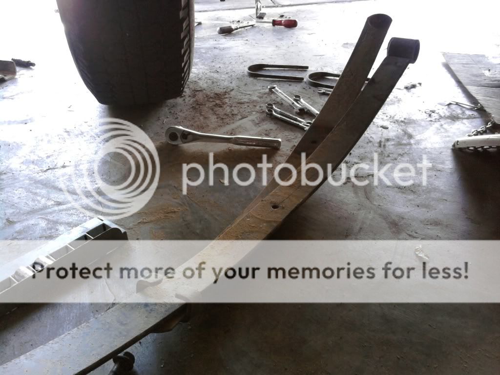

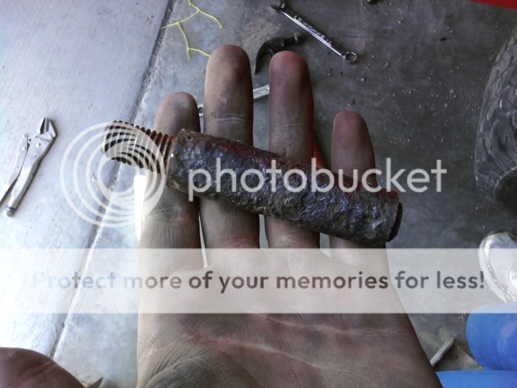

I've been trying to get these leafs in the truck for months now. but there was a bolt on drivers side forward that had rust welded to the bushing sleeve. soooo got me an angle grinder and had fun slingin sparks today:headbang:. I swpped from 2leaf with overload rangers to 3 leaf with overload explorers
leafs i'm putting in^

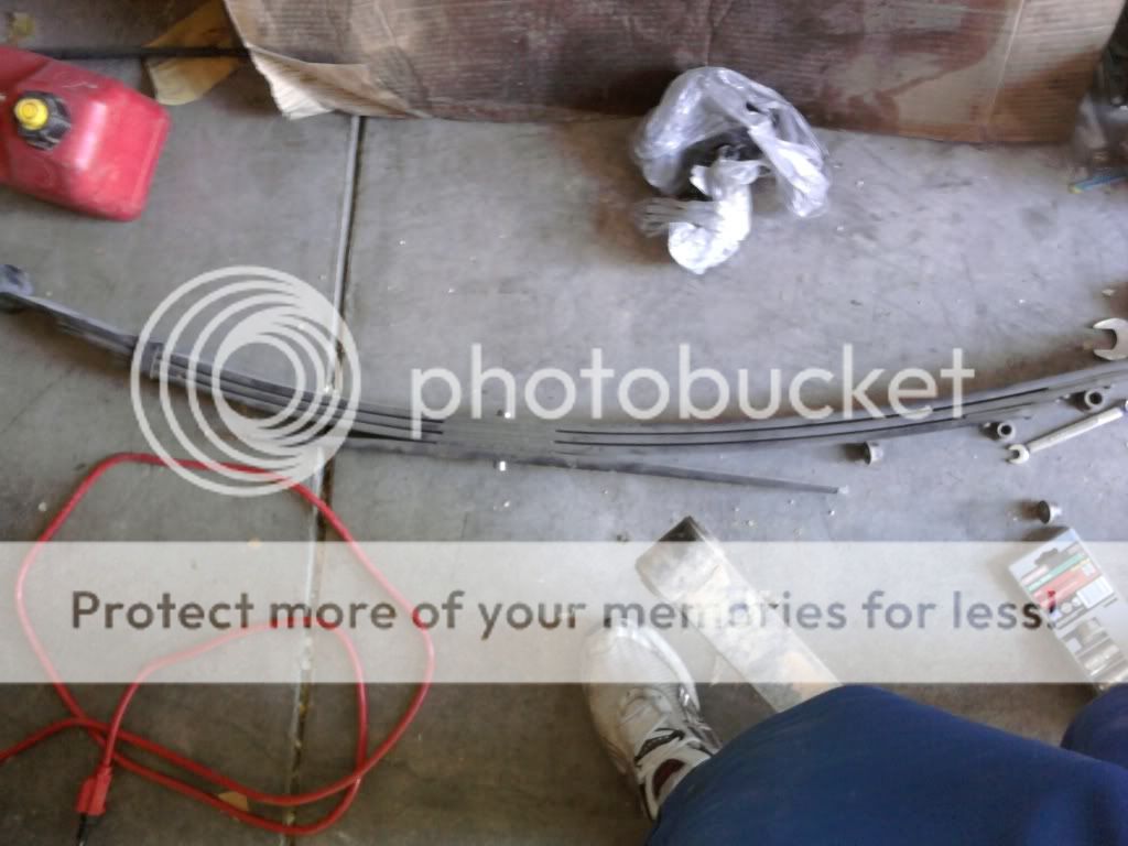

I got the center bolt stuck in the perch so i had to take the leafs apart to get them off and then hammer the center bolt outta the perch.
One of the biggest PITAes i have ever encountered. cause the parking brake cable bracket is right there and i didn't want to cut through it.

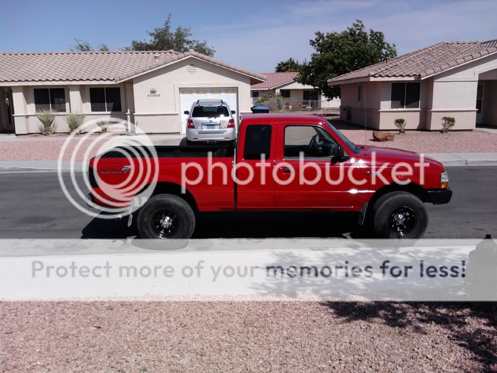

how it sat before
How it sits now
Not really a height diffrence but it rides a bit stiffer nice for when i put my quad in there
not quite i have spacers for the front not sure if i wanna cut them for 1 or 1.5" lift but then i might look into bigger tires
i know they would fit but i only have 3.73 gears and i'm married and in the military and i need to drive back to NJ. not enough money for the gears
