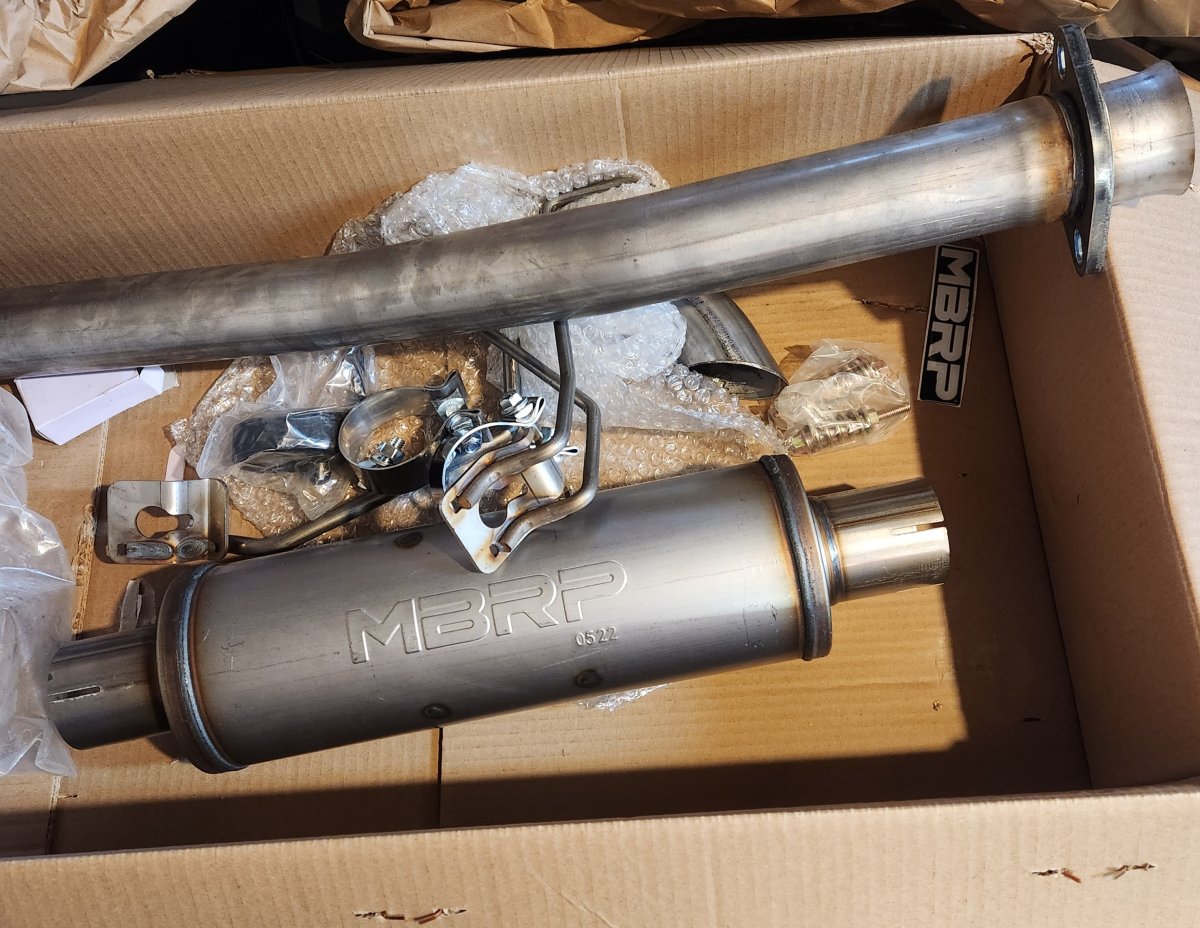

I have a MRBP stainless exhaust and it came with band clamps. I've never had much luck with them not leaking. I typically do a smear of exhaust putty when assembling the joints. I've seen a lot of people recommending high temp RTV and swear by it. I'd be tempted to just use regular exhaust clamps but the hangers get installed on the band clamp bolt.
I only want to do this once... thoughts/experience on sealers?

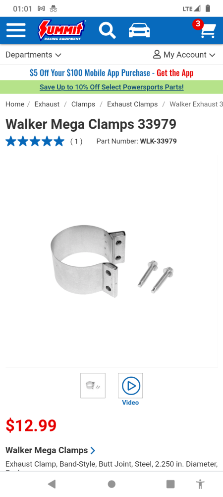

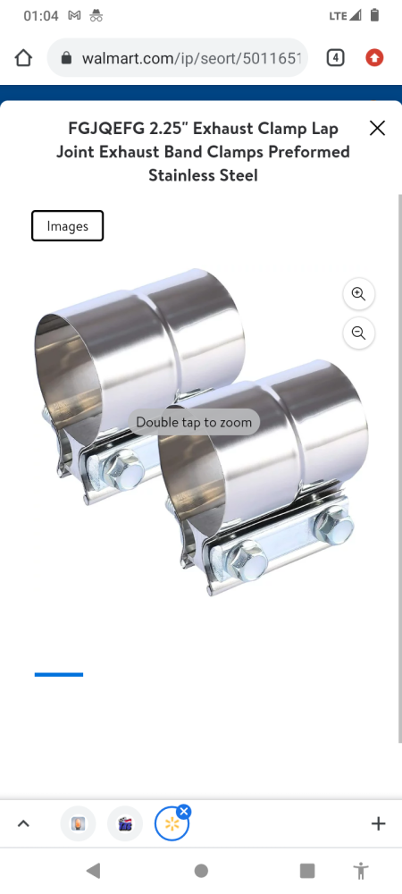

I have been using band clamps on every exhaust I've ever set up (never had a welder) without a sealant; I did coat the sealing surfaces with WD-40, just to help them slide easier. I have not had one leak yet; I build my 1st in 1995 on my Ranger, all stainless, it is now as it was then.
The 3" wide band clamps come on 2 styles butt-joint and lap joint. They sell sets of pairs on Amazon and The Walmart.com

that system is built for those band clamps. do not u bolt that or you will destroy it. lap joint and sizing can be tricky though. that may have been why you have had problems in the past...using sealer on a properly fitted slip joint will usually cause problems.
That's good looking stuff, I'd use the clamps they sent before doing something different. If you decide to use U bolt clamps, be careful not to overtighten them.
