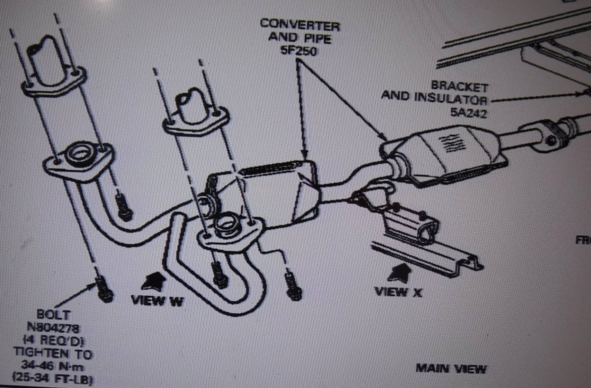

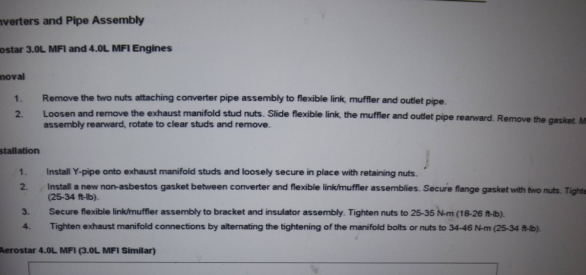

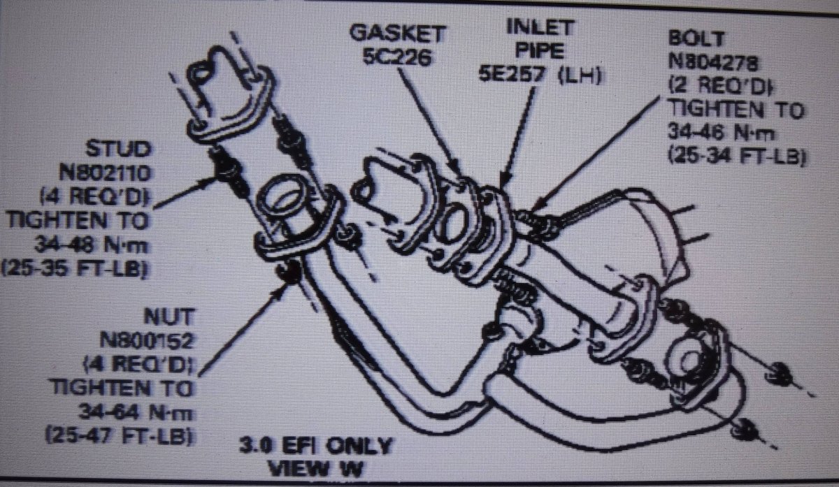

I could not get the 96 disc to work, barely got these, they are from 93-94, not sure they are totally correct either :/
The number is N804278 (14 required)

If it is anything like the 93-94 system, and I would expect it is, there are upwards of 14 identical bolts.
Most if not all of the bolts on this system are in the undercarriage and somewhat protected from weather
I do not recall them changing exhaust systems at any break necking pace
If you found even one that was somehow even similar it seems you could easily get a handful of them
