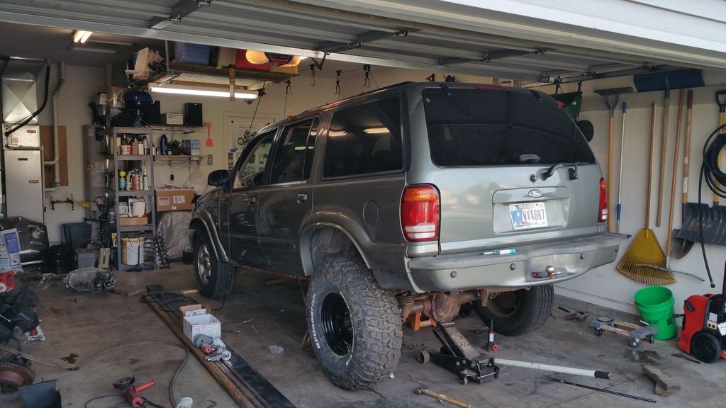

Started removing the rear axle the other day. Had to either cut or heat everything to get the axle out
Sent from my SM-N910T using Tapatalk
And today got the rear axle all cleaned up and placed under the springs. Nothing is welded yet.
I think I will need to keep the small tires on it to get it out of the garage. It will be taller than the ranger. Tomorrow I start on the front.
