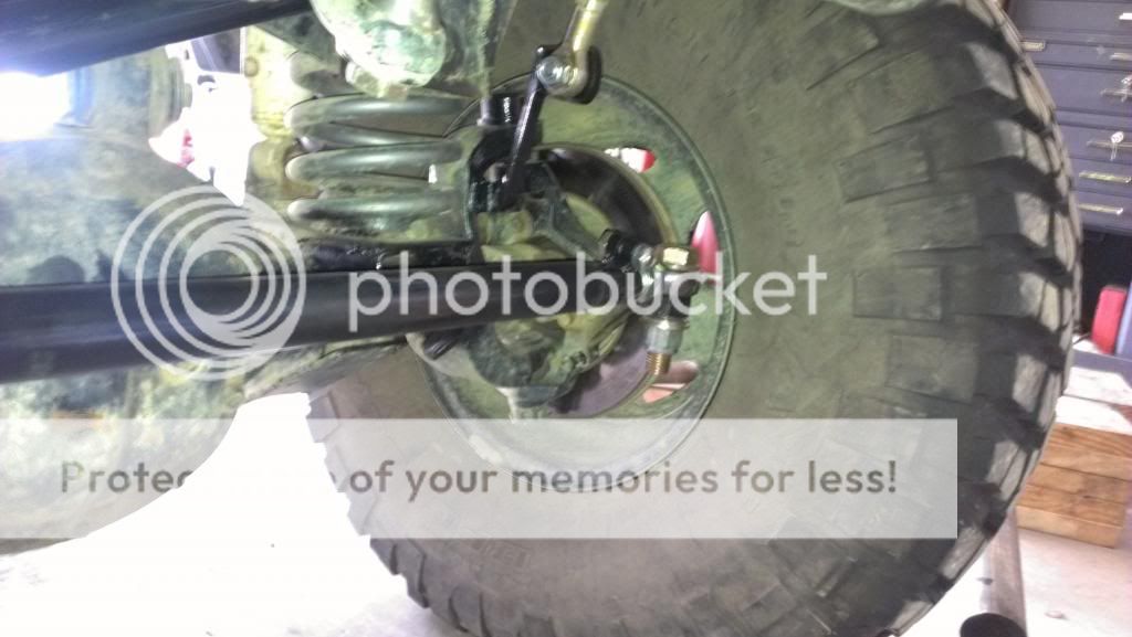

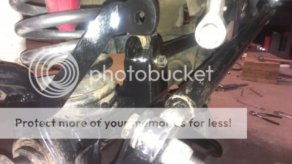

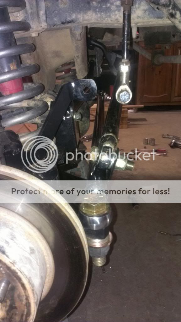

I had to redo the steering because the tab for the draglink was to tall and was also hitting the swaybar tabs. This also was creating a huge dead spot in the steering.
This would make the tierod rotate when turning the wheel creating the dead spot.

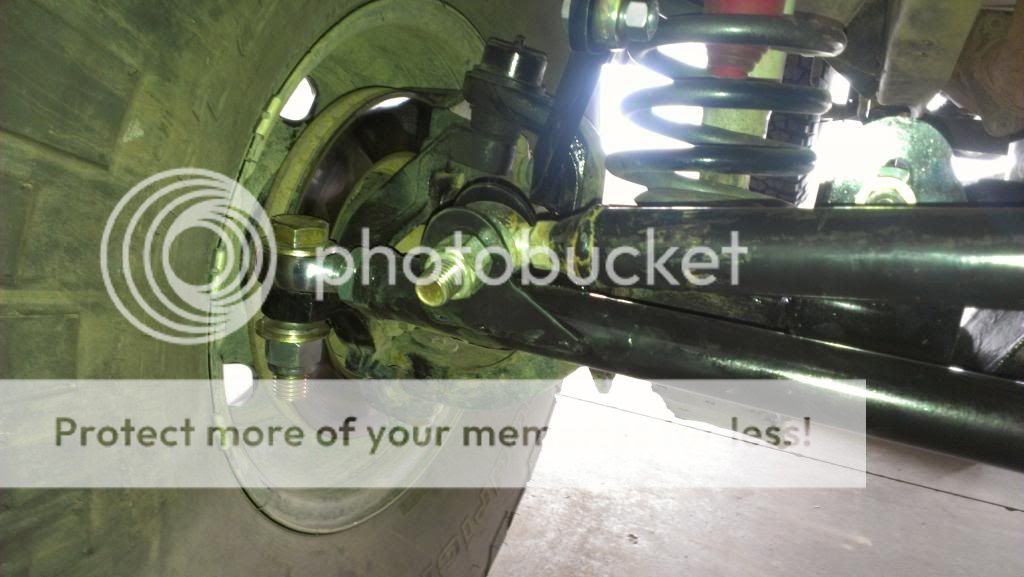

I wanted to get rid of the TRE and go with HIEM to help eliminate the tierod twisting. And to get rid of the large tab for the draglink, I made it over-the-knuckle.

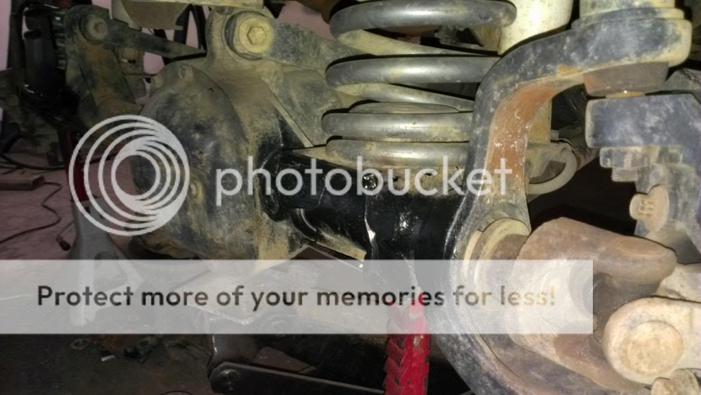

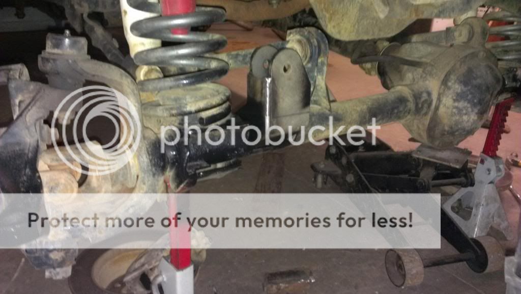

To make it OTK, I had to remove the swaybar tabs from the axle and relocate the trackbar mount.

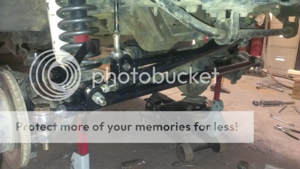

Here you can see where I cut and trimmed the swaybar tabs and removed the excess coil mount area. And the relocated trackbar mount from Rusty's.
here you can see the better angle of the draglink.

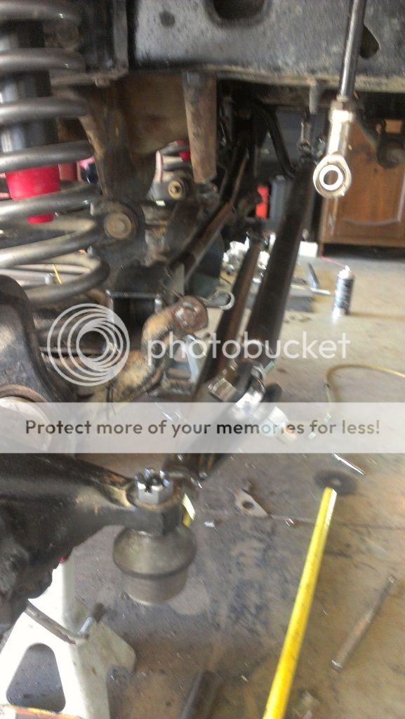

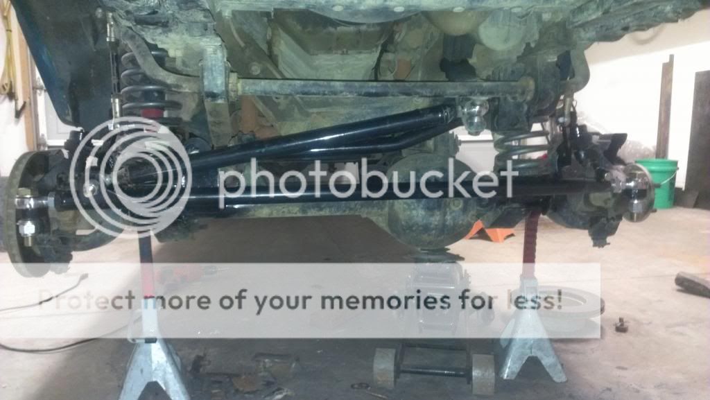

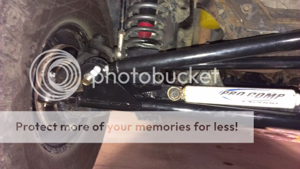

BEFORE:
AFTER:
Finished.

I like where you mounted the sway bar links to the inner c's. I may have to do that.
Sent from my SPH-D710 using Tapatalk 2
Looking good.
-PlumCrazy
Thanks, I wish I would of gone this route first.
These were from Rusty's. I was skeptical at first but worked out well.

looks really good:icon_thumby:
just need shorter swaybar links now....
l8r, John
l8r, John
Thanks.
I will shorten them today. These pics were taken right before I took it for a test drive.

Did you pre-heat that inner C? Either way, I'd think that would have created a stress point and now a weak spot in the already weak D30 C's. Other than that, it looks great.
