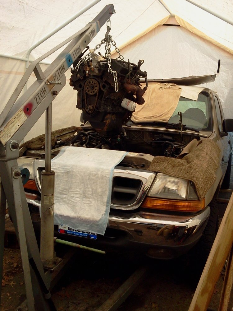

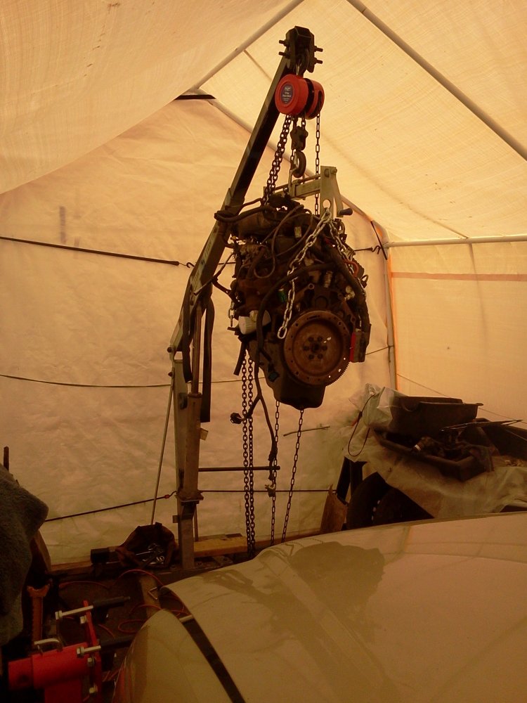

lifting the engine with transmission attached would be a challenge because the engine bay is short.
the assembly would have to be almost vertical.
I had to re-rig this a couple times because the intake & bar hit the firewall.
hanging from the chain hoist has advantages. the engine drops straight down and I was able to lower it while laying on my back under the truck.
easy to move in very small increments too.

What lift chains are you using on that top photo? Is that just 2 regular lengths of chain with bolts ?
my long arm 2 ton has plenty of lift. goes up to about 9'
Yeah - point of clarification regarding the HF jack and my experience with it. With the transmission attached (on the 3.0 combo to an extent, but particularly with the 5.0/4R70W) it's an extremely tight pull. If memory serves, I removed the 5.0's tall upper intake, and still left some permanent scars on the core support along the way.
2 24" chains bolted to the heads
that was pulling the 3.0 out.
second pic is putting a 3.0 back in.
