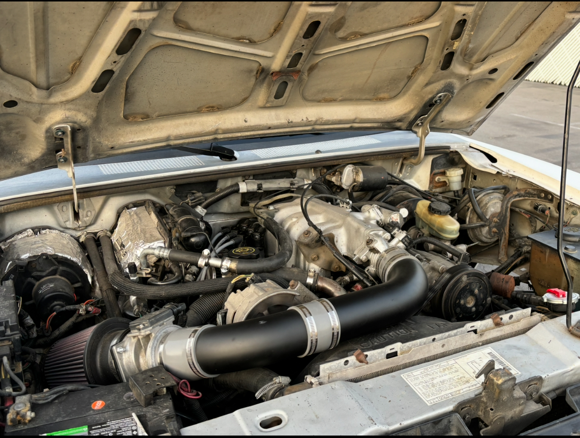

Hello there, I have a 1991 Ford Ranger 4.0 and this is an intermittent problem but sometimes while cranking to start, the engine comes to a halt as if ignition is going off at the complete wrong time or maybe it’s a cracked head and the water is turning into steam and halting the piston on its way up. I’ll go to crank again and then it starts fine-ish and runs normal. This problem is concerning to me because it has wiped out one starter already and I am afraid to cause more damage like bending a rod if that is even possible. It sounds terrible when it happens… stressin me the hell out 😆
So far I have :
-Properly cleaned MAF
-Motorcraft air filter
-Denso coil pack/wires
-Motorcraft plugs
-Motorcraft crank position sensor
-Autozone reman ECM
-Delphi Air Intake Temp sensor
-Denso o2 sensor
- “ New old stock” Motorcraft ignition control module
I think that’s it so far…
I just wanna get the truck to not do this anymore lol. I would appreciate any feedback.
My truck :
Thanks for looking!
PS I will now try cranking the truck over while performing the full throttle “injector disable” for a few seconds before going to start it to clear out any coolant drips if there is some in there… then start it and see if it helps.
Overall the truck needs some serious engine work. Leaks oil like hell, valvetrain noise when cold, probably has a cracked head. It runs fairly decent though considering. Eventually I’ll just tear it out and replace or rebuild. I like OHVs. Working on making more dineros so it’s not so financially straining.

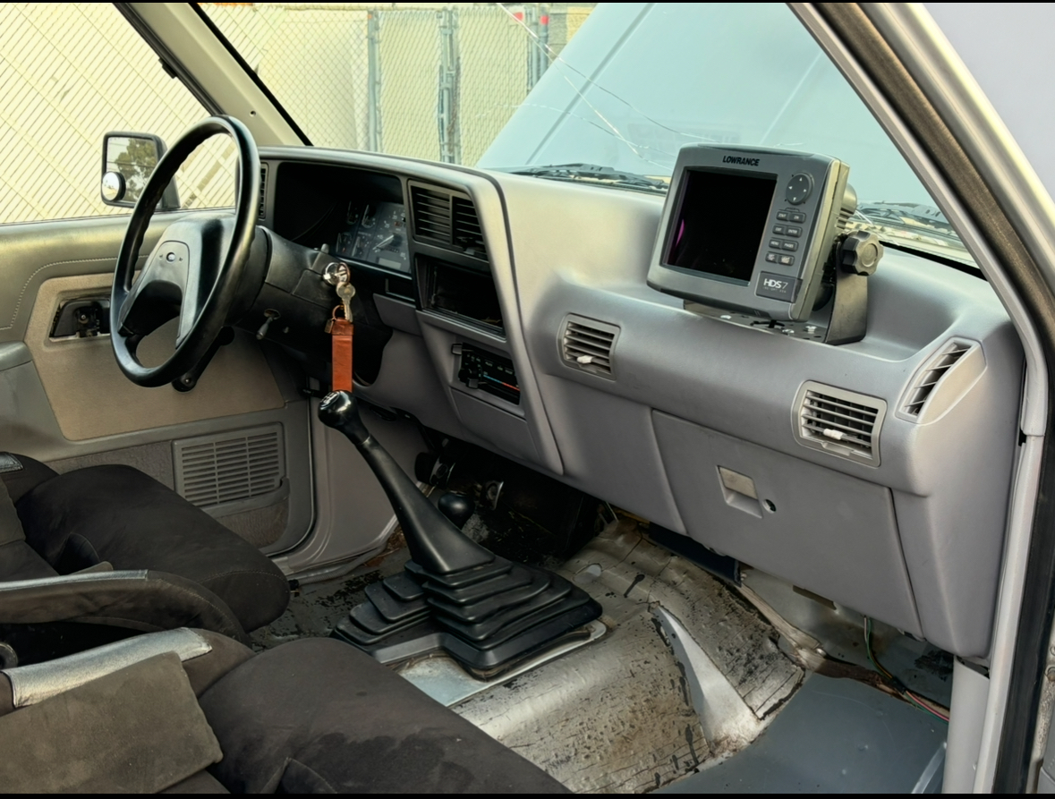

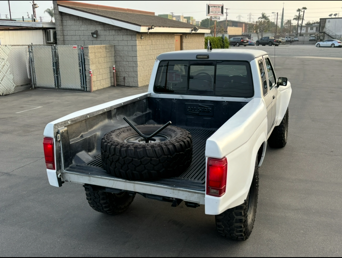

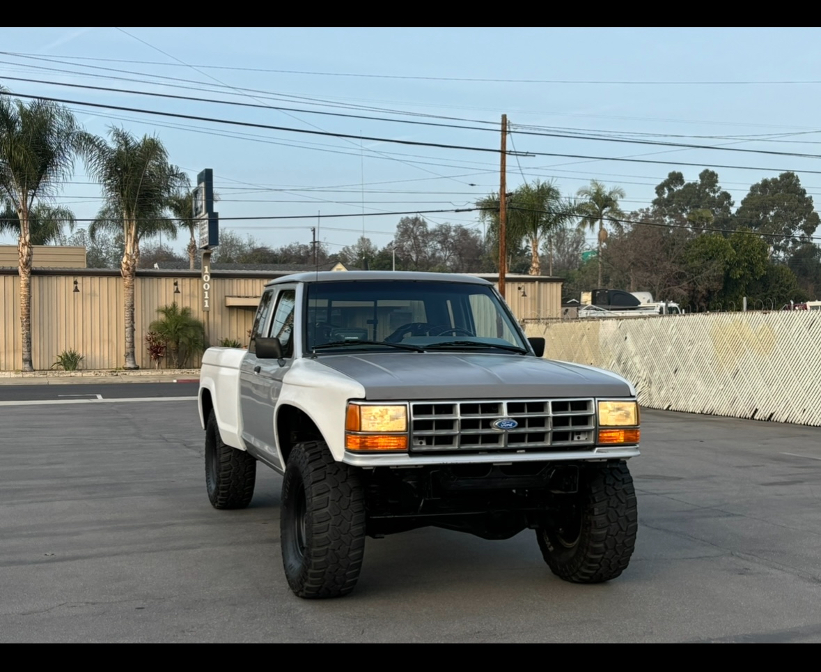

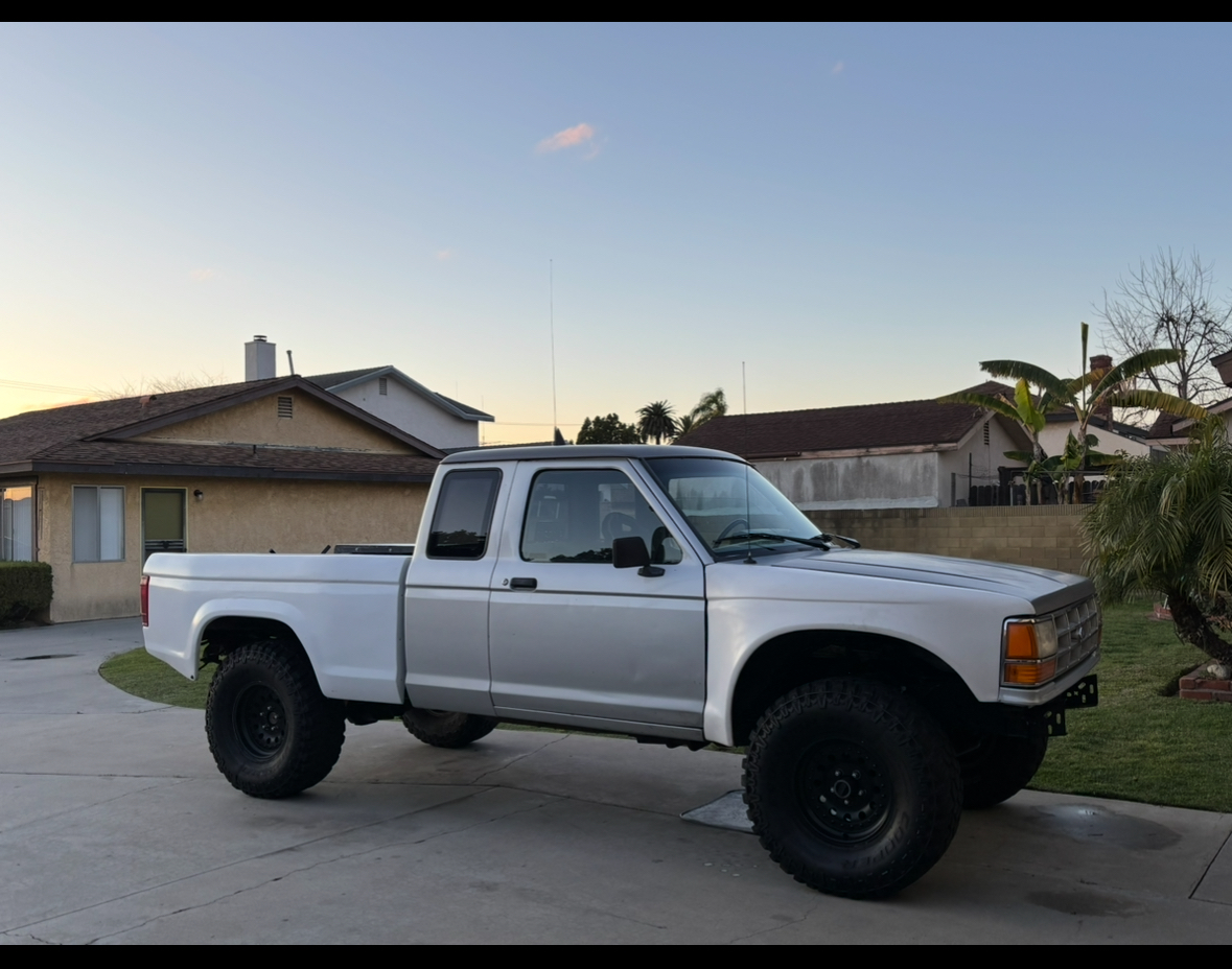

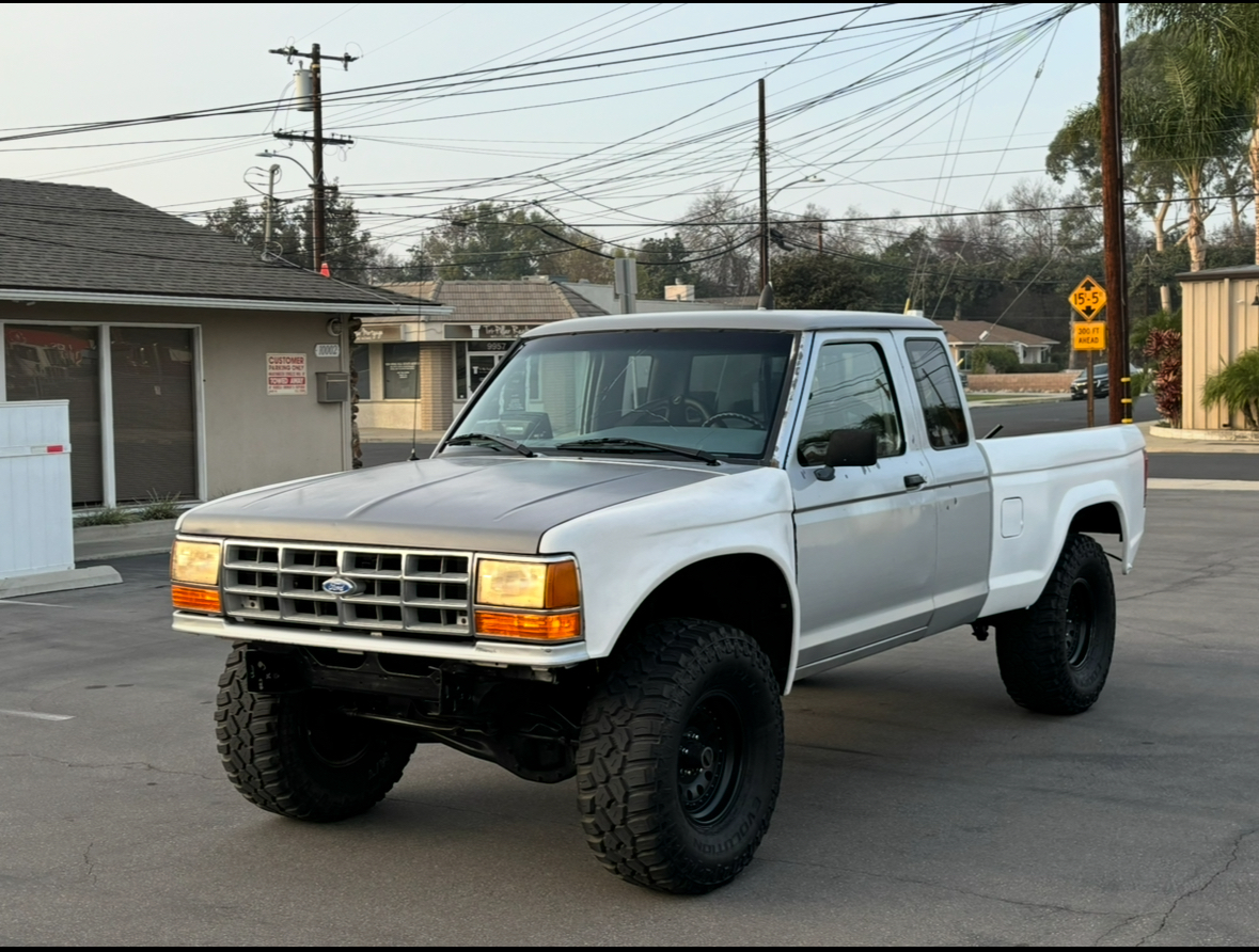

I can't help with your problem. That said, you can't just drop pictures like that and not give any details.
To be fair, I bought the truck with glass already put on it with the wheels and tires.
I put skyjacker leveling coils in the front and bilsteins all around because the ride was hell and honestly dangerous lol. I mounted the spare with a fabtech kit thing… super simple. Hmm.. it’s gutted basically with racing seats. It’s a 4.0 5 speed with both manual transmission and manual transfer case. The A/C does work !
The plan is definitely to do prerunner things with it… been welding at work a lot so just practicing to get to a point where I feel comfortable welding on the truck. Money is the thing just doing what I gotta do to make more of that, the truck is a motivator for sure. Overall, it’s not much right now. Basically a leveled truck with glass on it lol. It has a Blowmaster 40 series and no exhaust after it under the truck so it sounds good.
