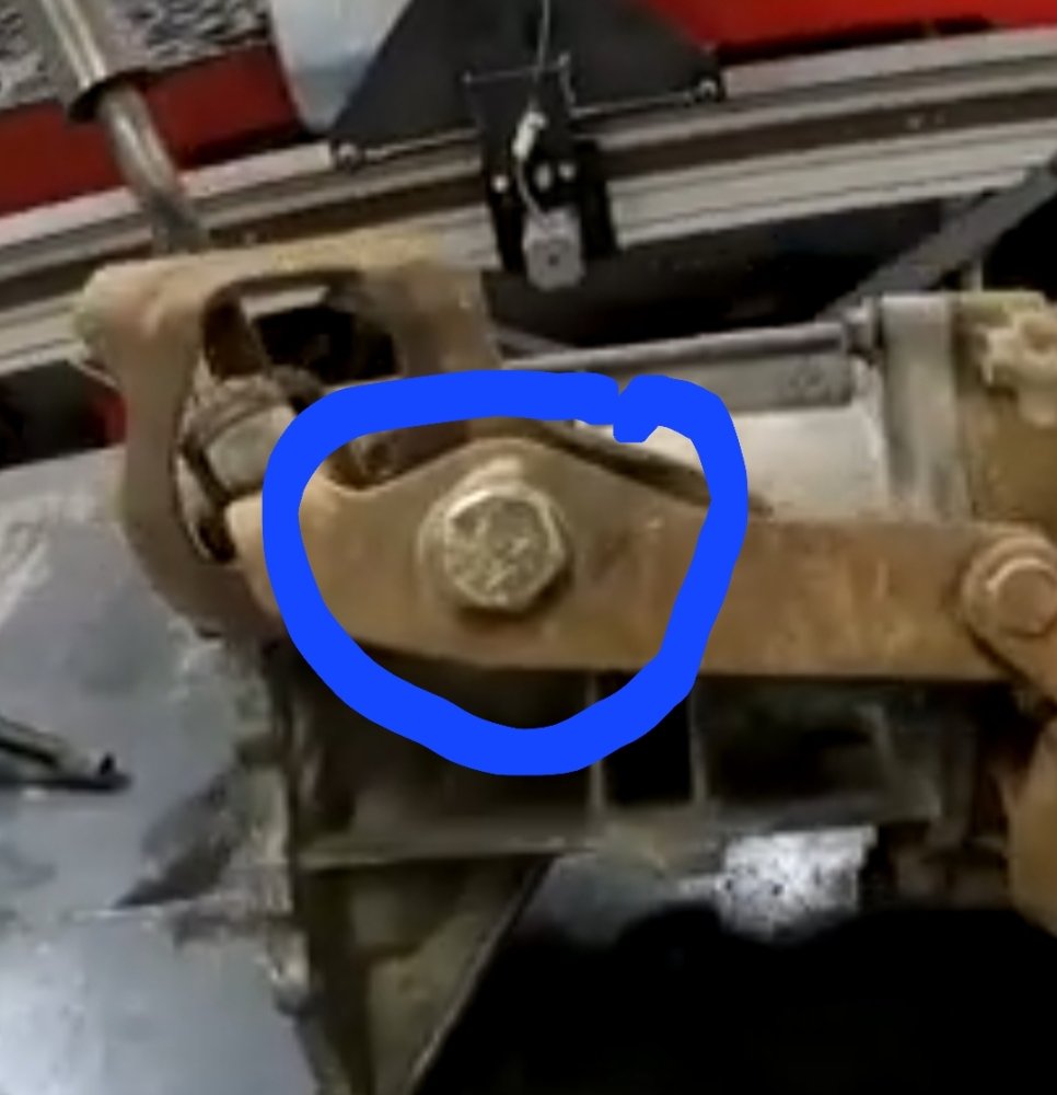

I have a 93 ranger Electric shifter i found a manual 1354 in a salvage yard no shifter and I can't seem to find one so ima have to try n make one what size bolt is this ? And any ideas on a easy way to make a shifter.

This is all I know about that.
Electric case to manual
Shit that says alot it's a start on the threads n size thank you
If you are ok with not having the gates on the shifter, it can be a simple flat piece with a fork on one end the shift knob on the other and a center pivot.
