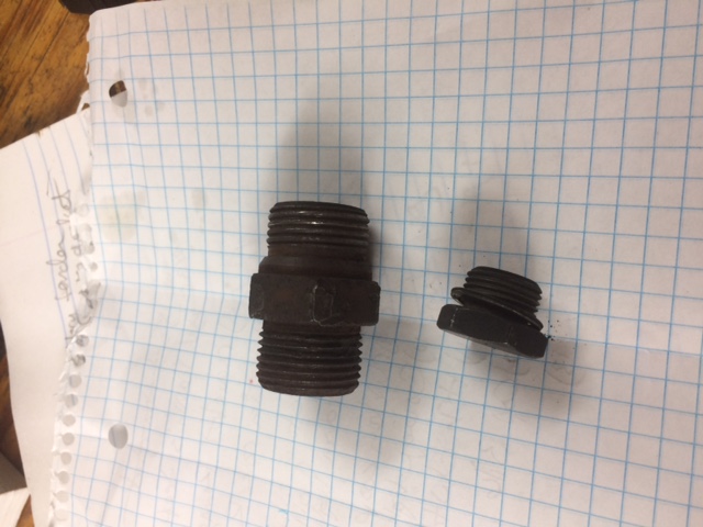

So I replaced the cracked exhaust manifold on my 85 Ranger. It was a different casting number than the one I removed but fits fine except for the EGR tube fitting. The one I removed has what looks like a 1"-13 thread size and the new one is much smaller at 11/16 -13. Is there an adapter available or maybe I can buy the entire tube and cobble something together? I saw where Dorman offers EGR connectors but apparently they can't look them up by thread sizes (ridiculous).
Here is what I am dealing with:

  • EGR Tube connector

I just went and looked at my Mustang 2.3L and the EGR tube connector looks like the two sided one you posted.
That's odd. Could be the new exhaust manifold is not a genuine Ford part and they were lazy and just tapped the EGR port the same size as the O2 sensor.
That does look like an O2 sensor hole plug.
On mine the EGR port is right before the collector, and faces almost straight up.
Where did that plug come from?
It's right where the EGR is on the old manifold.
The O2 sensor is mounted from the bottom of the manifold, straight up for 85 model year.
If the diameter of the new EGR port is smaller... have it tapped to a larger size?
If it has a FoMoCo part number cast in, the E6 number, check a boneyard for an 86 Mustang with a 2.3 and snag the EGR tube from that... cut and paste it to the stub of your current EGR tube (use a union)
tom
Yep. The 02 sensor is mounted on the bottom near the collector.
Cool. I'll look for that EGR tube. Saw one on ebay but it was $80. Ouch.
