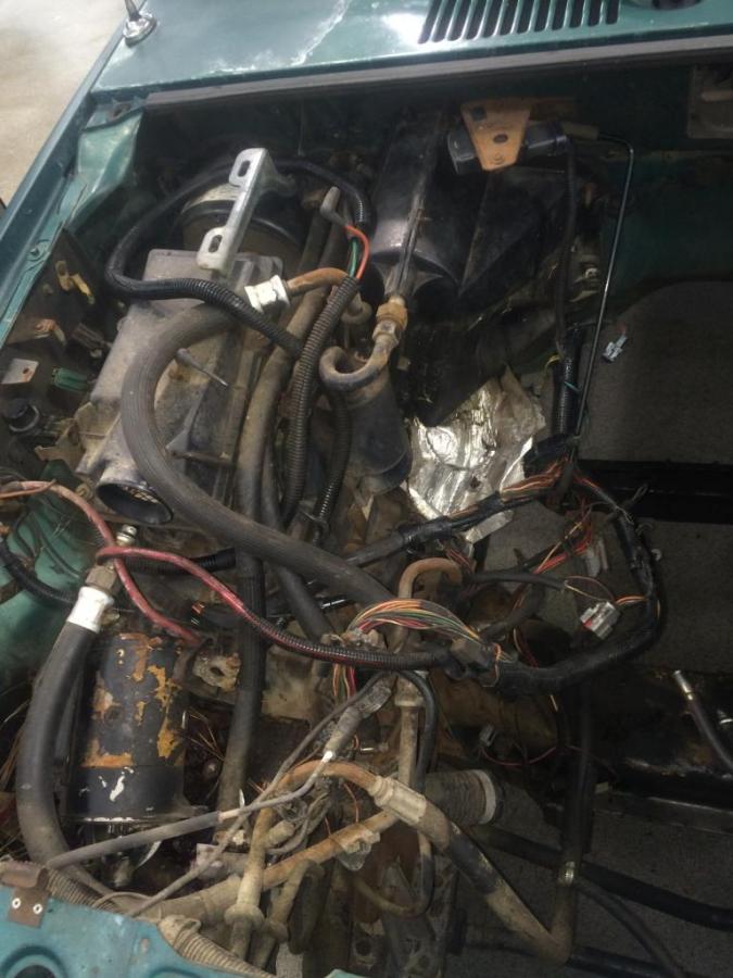

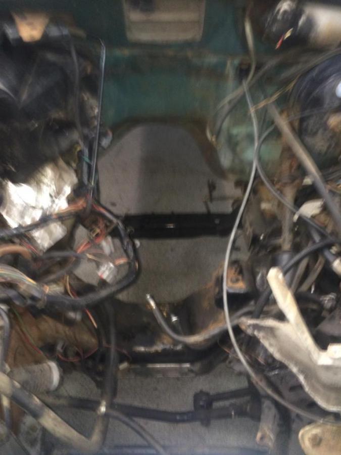

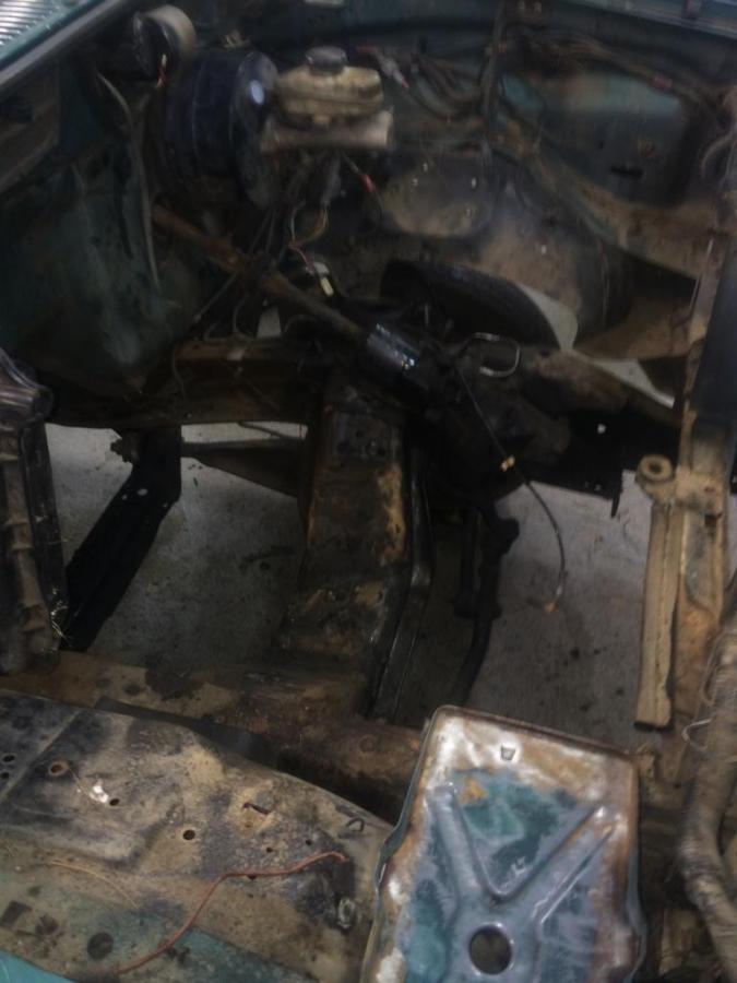

operation clean this garbage out
thats better

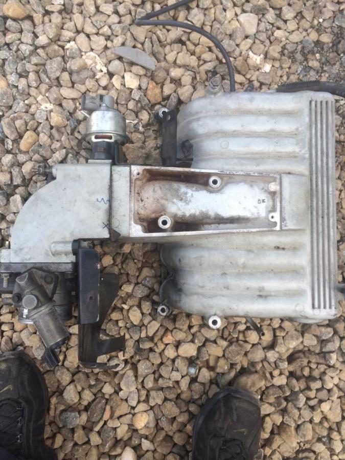

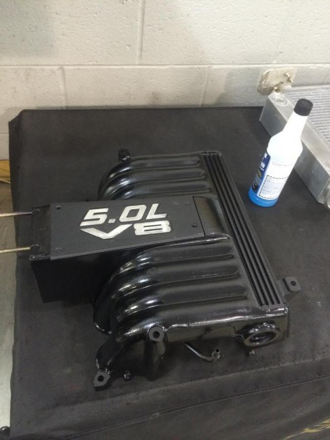

scored an intake from a 97 explorer...thanks to Ranger SVT for helping me out with some info. My 89 5.0 setup has a seperate IAT sensor and the MAF for this vehicle is a 6 wire that includes the IAT in the sensor....much cleaner setup and no drilling into the intake or anything for the sensor...just spliced the 2 iat wires to the MAF

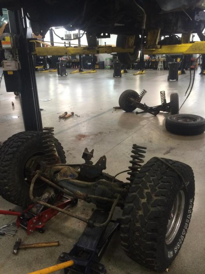

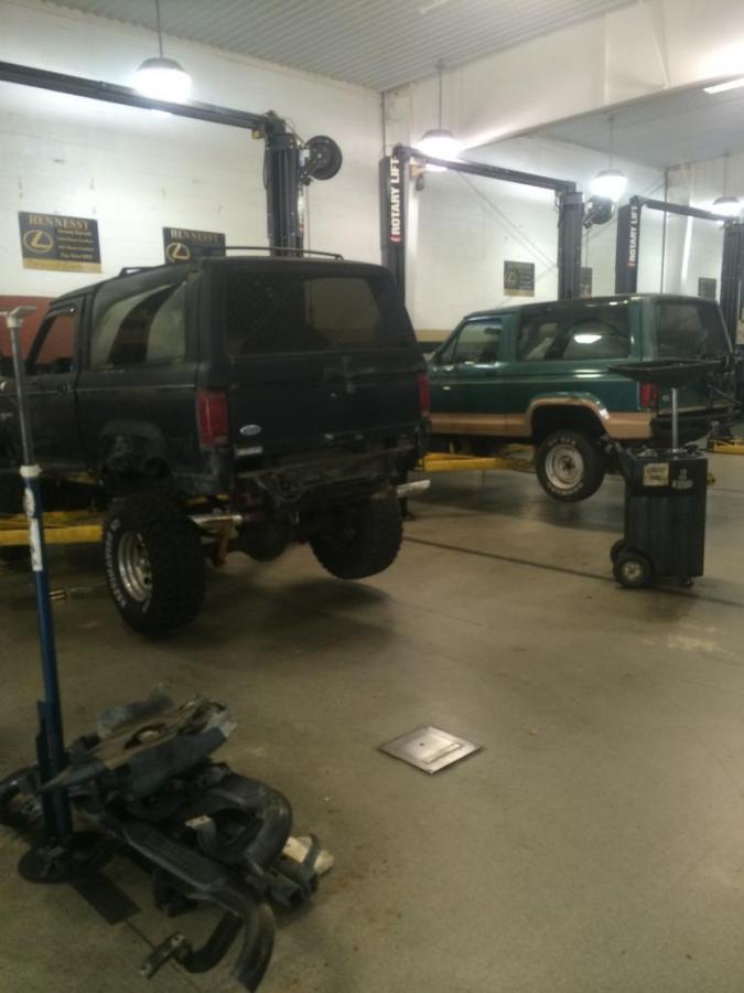

swapping the 8.8 disc braked axle out of my old rusted out Bronco 2

That black intake looks great!

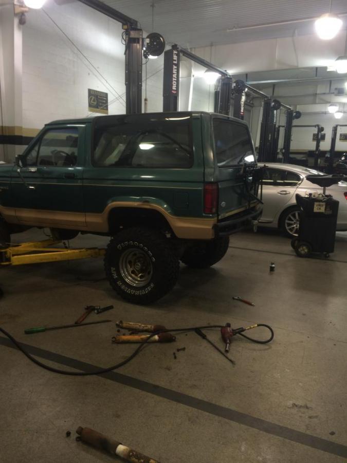

swapping axles!
