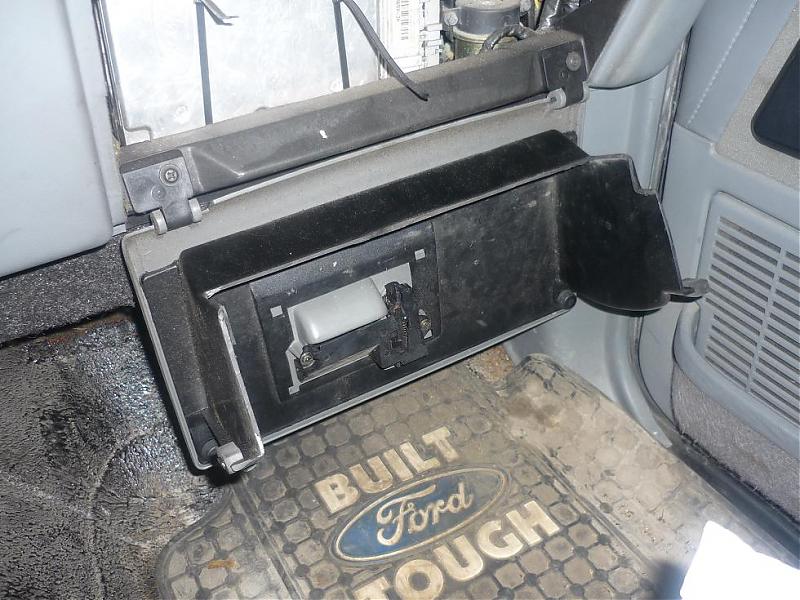

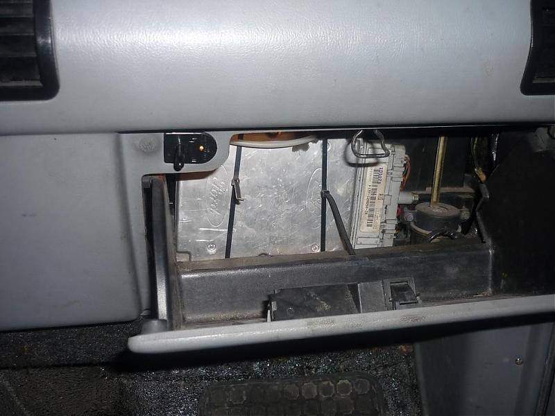

Here is where mine is.
Thanks for the info and the pics. I think i should be able to tackle this one now.
