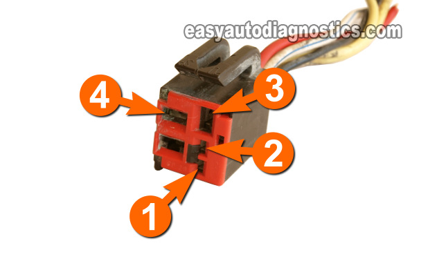

I'm getting a 1.4-2.1V signal across the EEC relay
The PCM pins are 85/86 (coil) and 87/30.
Whet voltages do you get referenced to battery ground in the relay socket with key on/engine off?

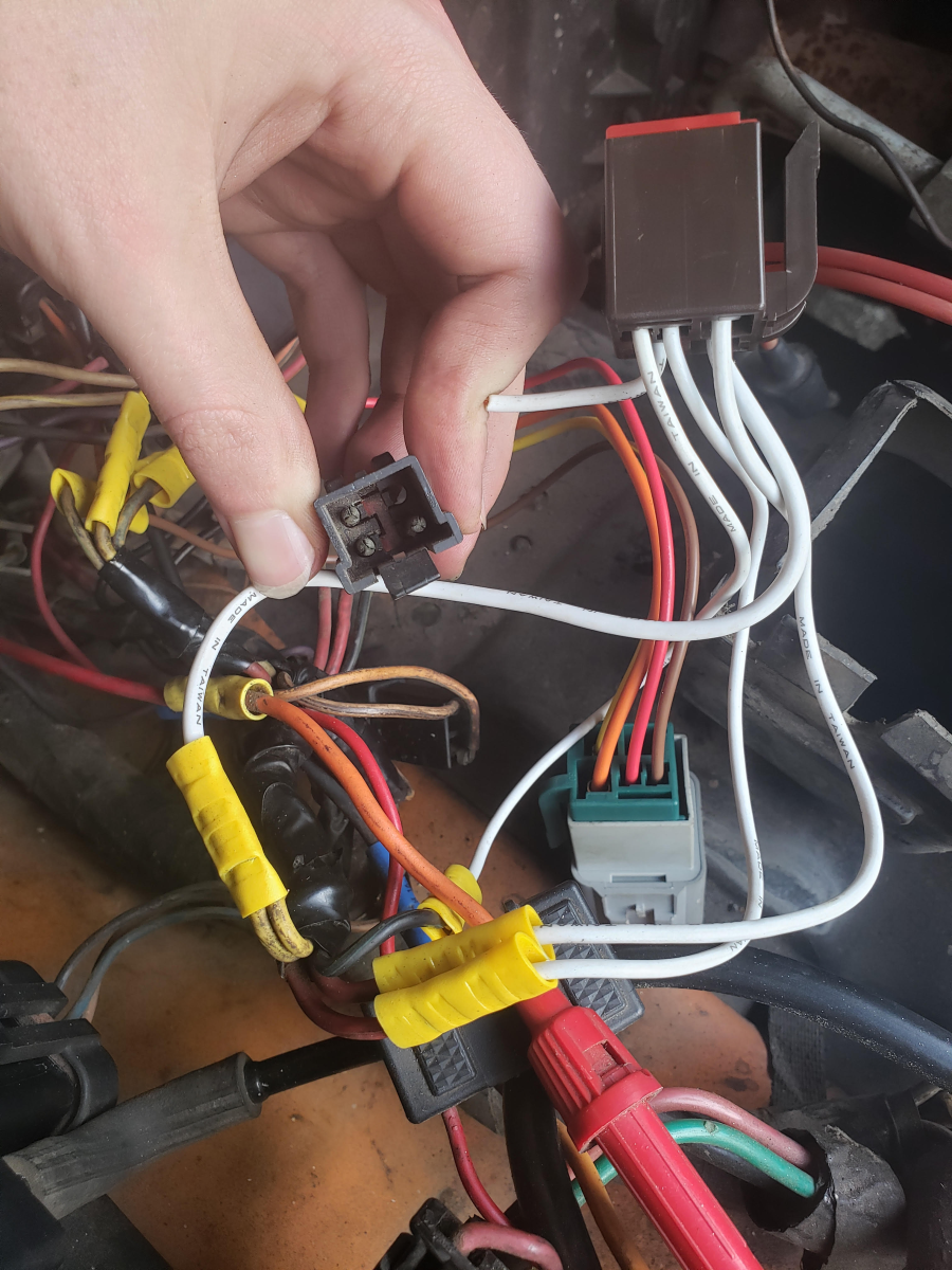

Alright, finally got around to trying to fix my Ranger this week, replaced the relays, checked for connections across the relay connectors and turned out all the connectors were working fine. Replaced them anyways, recharged the battery to make sure it wasn't a low voltage thing, still no start. Replaced the PCM with a reman one and nothing changed either.
At this point I'm assuming that it's a broken wire somewhere in the harness, should be between just a couple things, but was wondering if anyone had a good wiring diagram for a 2.9L with a PCM pinout so that I can diagnose it at the PCM connex pretty quickly. With the spaghetti wiring in there, I'd rather not have to trace stuff back through the firewall.

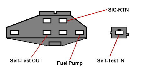

Ford went to the effort (believe or not) to give you a test port for the fuel system. It's on the plug where you plug in the code reader. With the key on, you can ground this test port and the fuel relay should click and the fuel pump should run.
If the fuel pump relay will not click, you need to do some checking with a testlight at the relay.
If the fuel pump relay clicks, then you need to check the crash switch wiring and the wiring back to the pumps. You can leave that test port grounded at all times with a alligator clip grounding it out, and it will hold the relay in and send power to the pumps at all times so you can take your testlight and start testing the wiring at the frame rail pump to see if you have power. And also the crash switch.
Once you get it narrowed down some, we can pull out the diagrams and see what you have going on, such as the relay wiring and what should have power and what will not have power.
Here is the port for the fuel pump test.

I actually tried all of this earlier in the thread.
Crash switch was unhooked and wires were spliced together from a previous owner. Tested applying 12V directly to the crash switch, the pump ran. Also, considering that not only does the fuel relay not start, but the injectors aren't going as well, I think that the problem can be narrowed down to that harness.
I can give the fuel relay a try with that method, but having replaced and tested for continuity at those places, replaced the connectors, replaced the fuel relays, and replaced the PCM, I think that my issue stems from that PCM wiring harness.
If the relay clicks and the fuel pump runs with the test port grounded, then I agree, it might be a wiring issue to the PCM. That is all the PCM does, is ground that same wire that is going to the test port.
