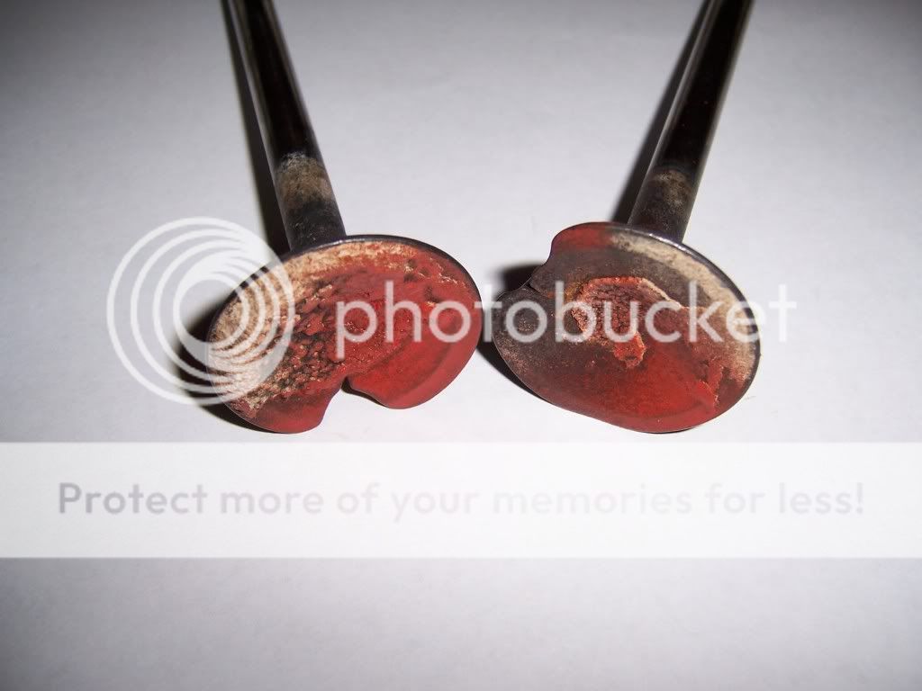

do an engine swap if you do find that your block is cracked. if its not i would go with option #2. looking at those valves makes me think the heads might be severly warped. it takes quite a bit of heat or a good old fashioned hydrolock to do that kind of damage to the valves. if you do repair this engine run some seafoam through her. itll get rid of all that nasty buildup.

well, i went with rebuilding the current heads. They were resurfaced dipped and magnafluxed. There were two small repairable cracks in the deck. Two exhaust seats were replaced and all six exhaust valves needed replaced. Total cost for the repair was a little over $395.00. That combined with the $150.00 for gaskets and bolts and misc sealer set me back about $550.00.
