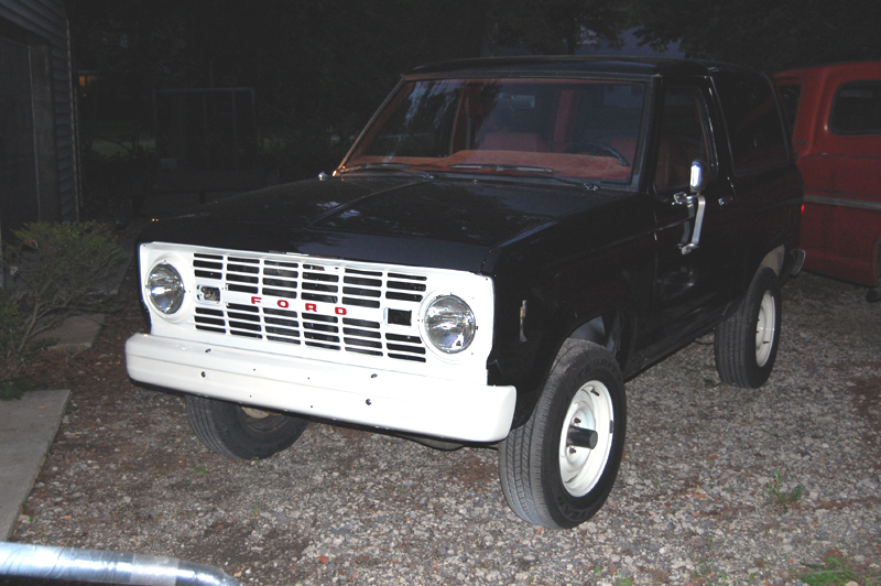

early Bronco grille pics
PetesPonies
Jan 1, 2008
1,168
east coast
1983
I still am looking for some marker lights, but its slowly coming together.
i've wanted to get my hands on an EB grille for a while to do the same exact thing. i could never find one for a decent price. anyways, looks good. i think it should be painted body color though.
white grille, white bumpers ( front and rear ), white roof and white wheels . . . nope not body color :) Old school only.
that is looking great.................... lovin' the OLD SCHOOL
That looks real nice on that Bronco, can't wait to see it done.
So what did it take to get that sucker attached?
Lookin good. :icon_thumby: Cant wait to see it with the white roof.
Wow! I love this. I had some thoughts a while back about building a early bronco on a BII chasis. Put the old grill on the front, 302 under the hood. I love this!
To attach an EB grille, it takes some mild fabrication skills. I had to trim the grille of its ends. The ends are part of the EB front fenders, so that part obviously had to be removed. Then a bit of cutting around the hood latch. I have a few screws holding the grille to the fenders, quite simple. It more trimming, acurrate trimming, than anything else.
