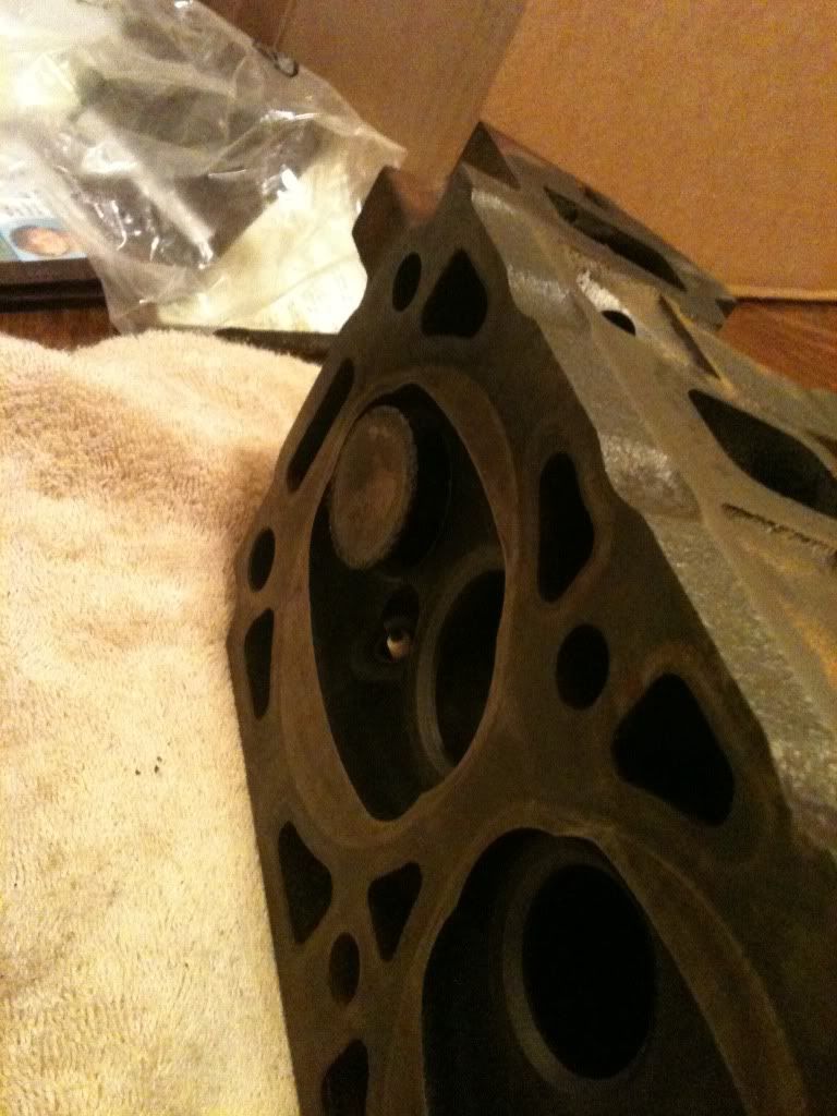

heads are decided upon: 47cc FFV castings
Head Gasket: dead soft copper cut to factory specs with sealant on water passages
Pistons: still working on, researching aluminum welding techniques for dome buildup
Crank: stroker (though not on the prototype engine)
Each of these treatments will effectively increase compression ratio. When i reach 12.5+:1 then i will work on the fuel related side

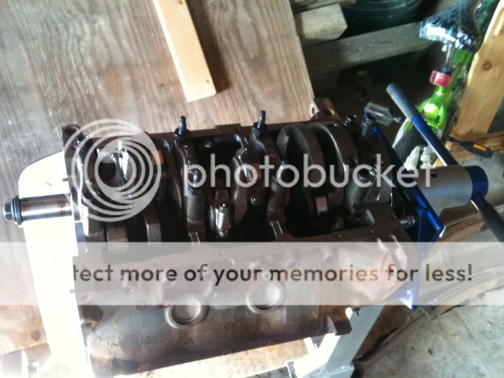

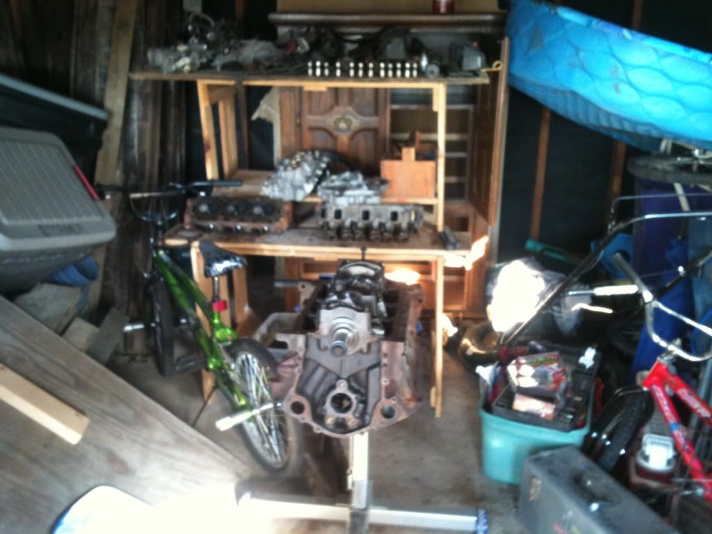

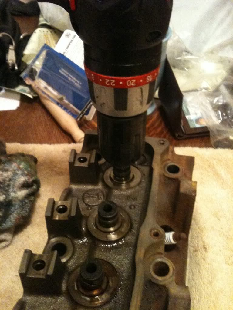

UPDATE!
well I now know e85 is not good for standard exhaust valves.. but i have learned a lot through these last 3 years, 3 heads and a crap load of work... the next motor will be spot on.
more to come in the next few days....
basic engine specs...
-2003 block with extra ribbing
-0.030 copper headgaskets
-2003 ffv heads, 47cc shaved 0.020
-stellite exhaust valves and seats...
-block decked, pistons 0.010 proud "O" ringed
-pistons 2003 ffv domed
~compression in the 11.3 range
I'll post the details later, going to carpet a hallway/stairway for a friend in an hour...
