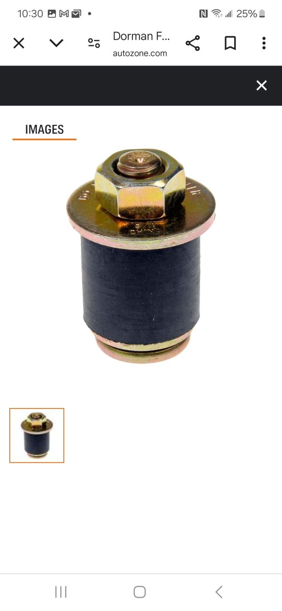

Just searched Amazon for freeze plug driver. There are a bunch.
They do make expandable plugs too. If you can get the room at a metal one... do it. If not...

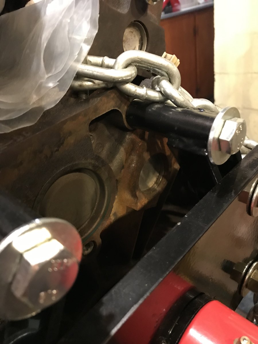

Oh SNAP!... just discovered that there's some freeze plugs on the backside of the lower block--i.e. gotta drop the trans to get them! :eek::devilish:

From what I've seen the ones that rot out are the higher ones, like in the heads. Old engines not taken care of may have lower rad fluid, which let's air access the frost plug from the inside. That combine with h2o leads to pinholes. I would do the head plugs then see if the problem is fixed before yanking engine or transmission.
... I would do the head plugs then see if the problem is fixed before yanking engine or transmission.
Shouldn't I eyeball a leak before I "do" ANY plugs?... :stop:🔎🔬

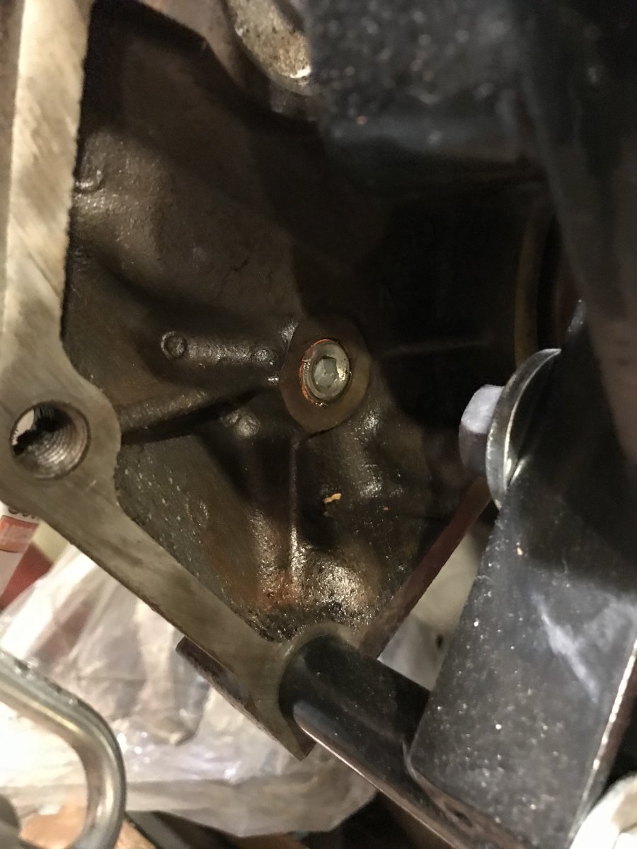

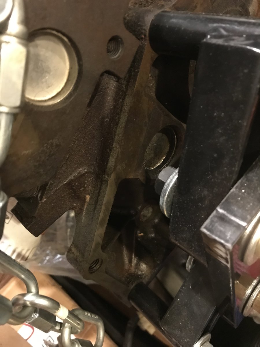

yep, 2 of them just below the heads. the big one is the rear cam cap, it would leak oil.
the small hex might be access to the oil, not sure.
you might be able to get mirrors or a bore scope in there, it won't be easy.
