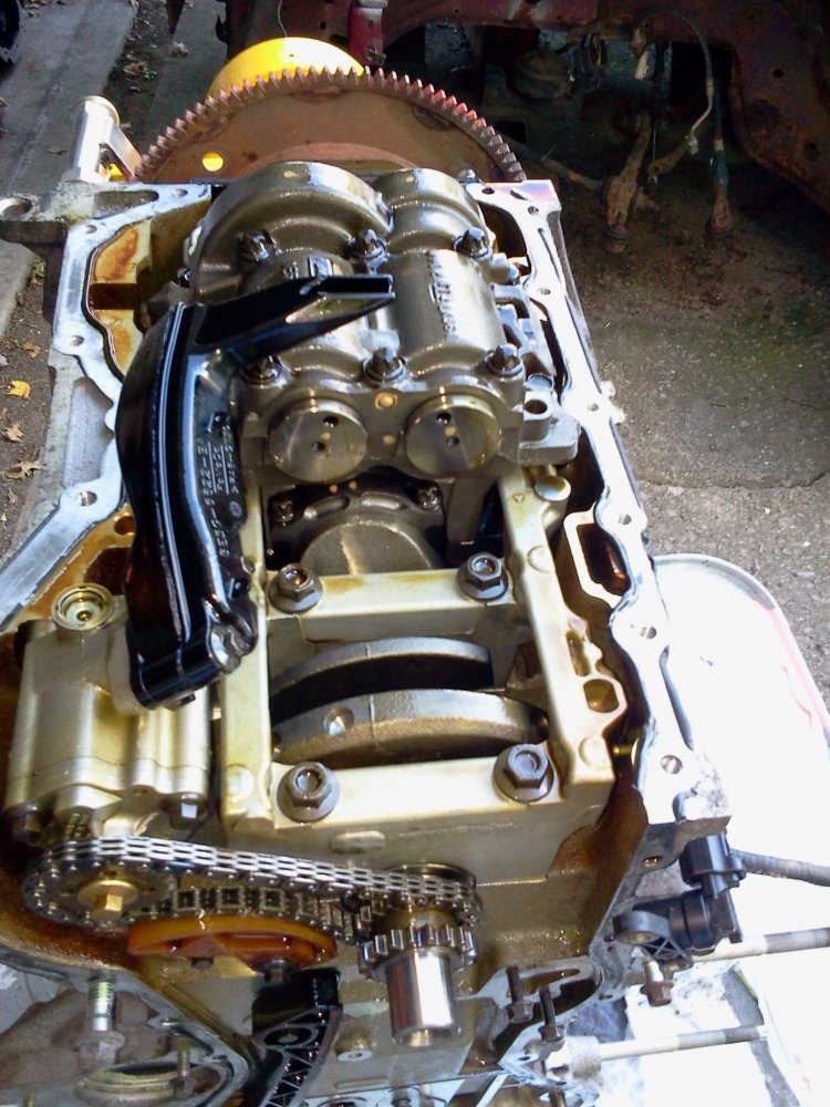

that may be due in part to a massive balance mechanism in the crankcase. or at least the '10 Fusion 2.5 engine has one.

The Duratec is probably the most modern engine Ford put in the older Rangers. They make more power and torque than the older Lima 4 cylinders while also getting better fuel economy and having lower emissions. They're super reliable as long as you watch the oil level (they don't have a ton of oil capacity). The coolant line that runs from the back of the head, and up the exhaust side of the engine is a royal pain to replace though if it springs a leak.
