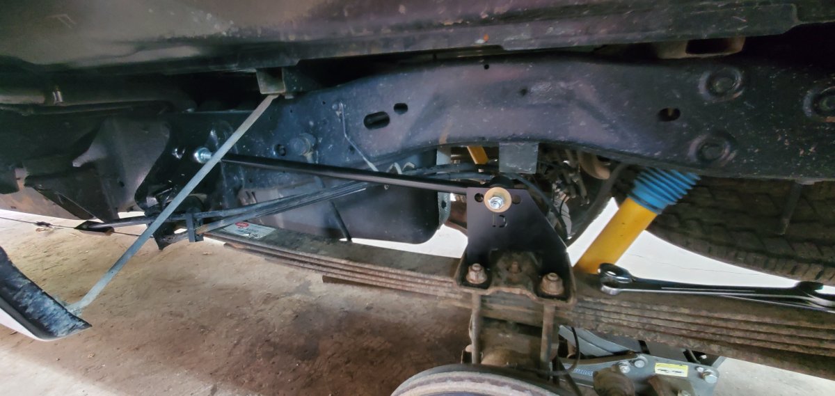

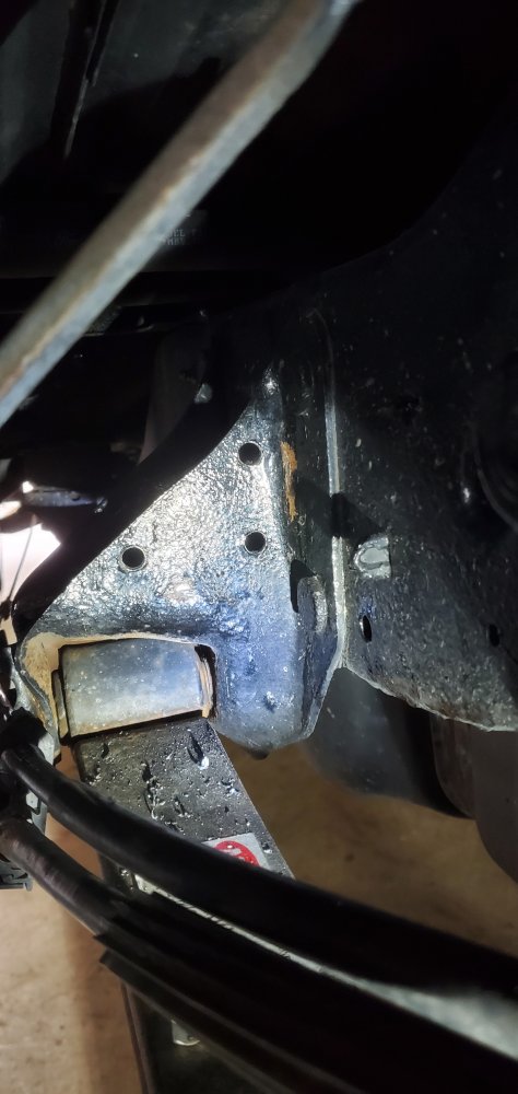

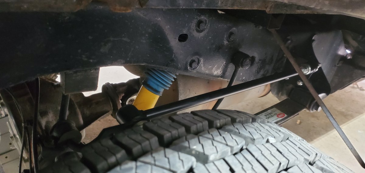

Putting these on the 2011 this evening:
Anyone have them? Love em? Hate em? Can't tell you have them?
I'll do some photos while setting them up.

I was wondering how they would work. Now I know...
They should do the trick.

Great bounce eliminator - takes the hop out of the 1750 lb springs.
Truck seems to be a little better at red lights with coming off the clutch.
Theyre subtle, but I can tell I put them on.

I had those on the 03 that I had back in the day. They really cut down on spring wrap-up, it was pretty clear difference at launch. I have not yet gotten some for the 09, but I need to.
