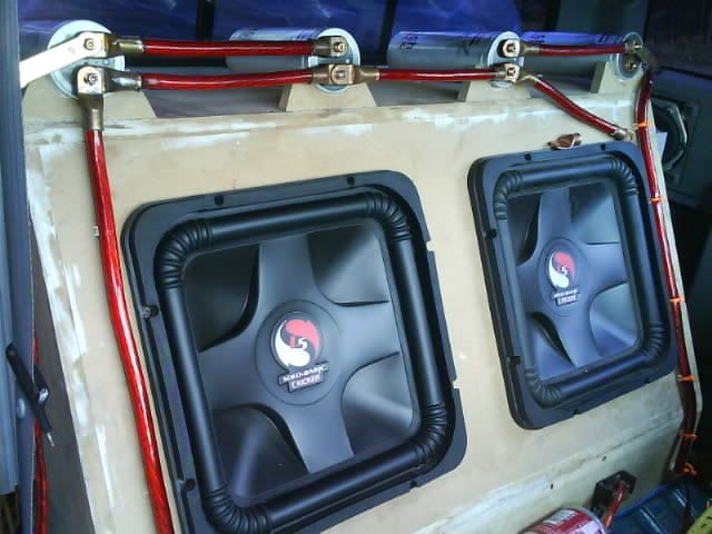

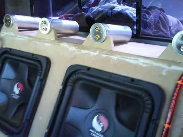

A little tip, those caps are probably more of a strain than any help. I know they were real popular when they first came out and everything, but they don't do shit to a properly wired system. They are only a bandaid for systems that pull more power than the wire they were installed with can handle, and then they still typically don't do what they're said to do.

You don't have to have the grounds isolated. They won't see each other. You can have several different voltages all using a common ground.

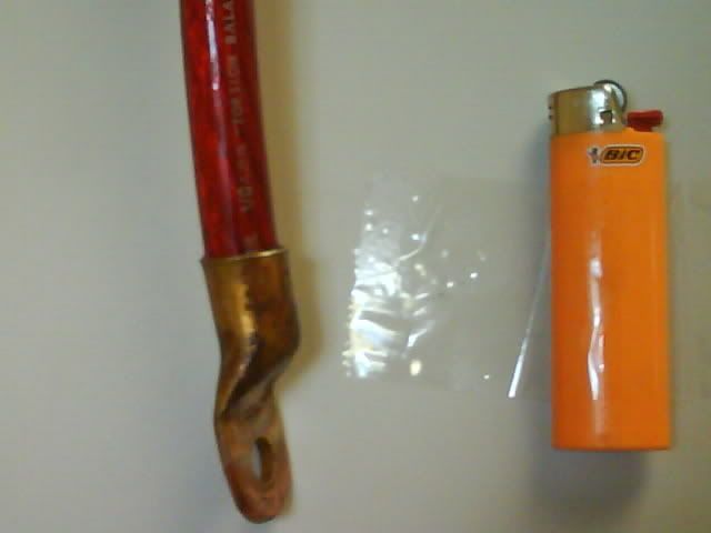

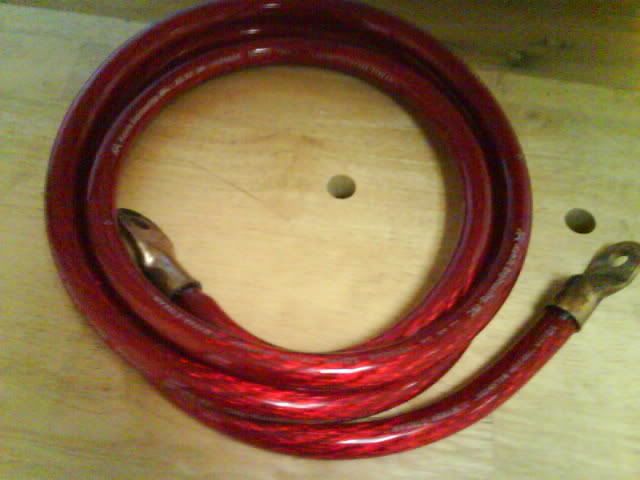

ive got a hifonics BXI2000d and a hifonics 4 channel that i forget the model number for? i am running 2"ot" wire from the battery through the firewall, down the drivers side floorboard, up the sub box, into and through the 4 fosgate caps, down into a distribution box and from there i change to 2 awg wire and go seperately into each amplifier. Forgot to mention that it is real copper wire not aluminum clad...here are a couple of pics for you guys!
