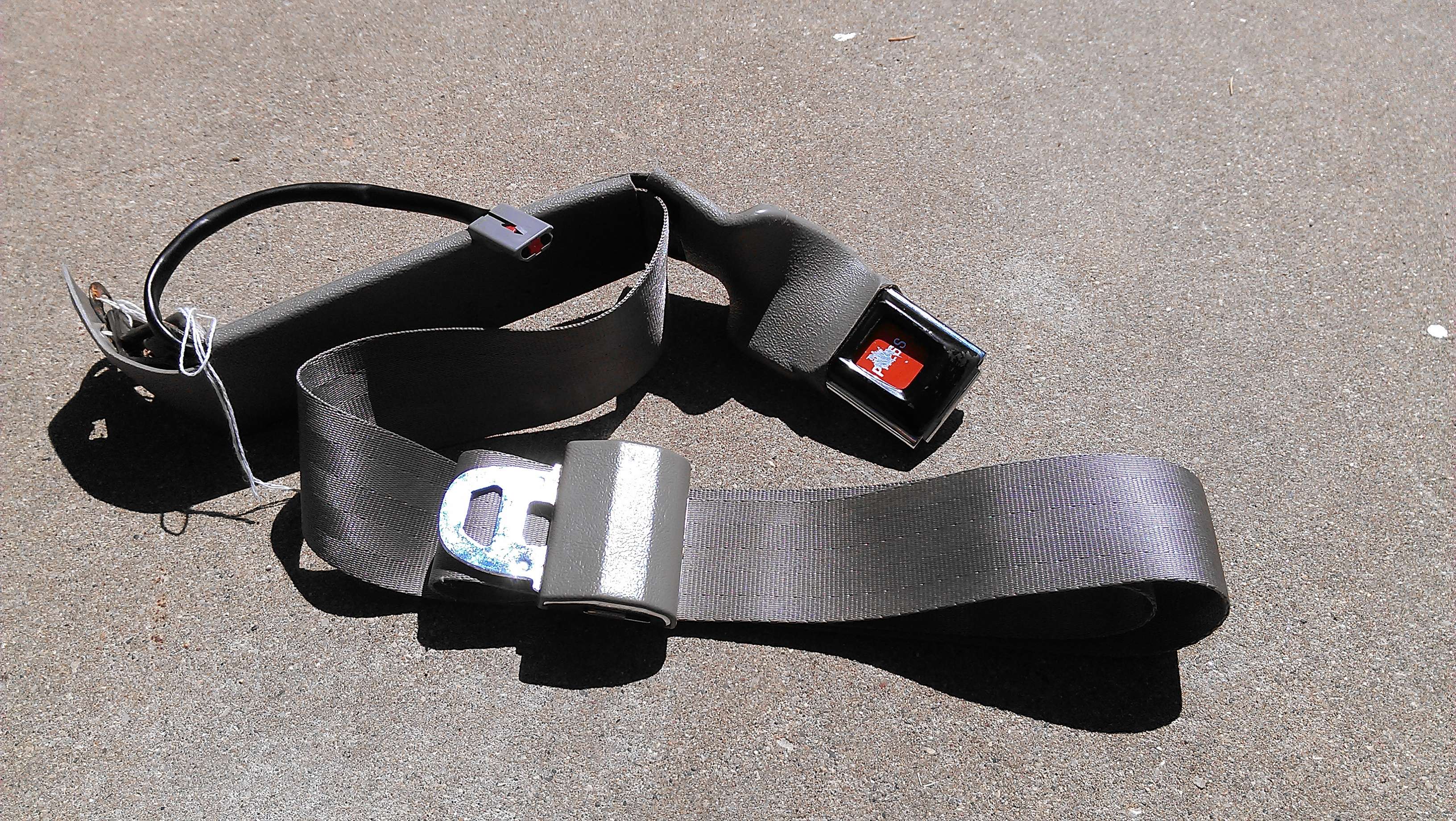

I have a 1997 Ford Ranger 2.3l and the driver's side seat belt buckle broke and appears to be unserviceable. I am assuming the spring broke on the inside of the buckle. It no longer retains the male end of the belt.
I have looked at a few local junkyards and the compatible buckles I have found were either already broken, and another one I couldn't get out because the torx bolt holding it in stripped. I need to get the assembly pictured that has the middle passenger belt and wire harness. It doesn't look like they separate easily.
Does anyone know where I could find one of these, or fix the current one? I might have to go to a dealer, but I'd like to just order one online if possible. I'm hoping to find a gray one to match.
Right now I'm using the middle passenger female buckle which will get me by until I can fix this.
I think LMC sells seat belts...but they are available if you can't find one in the junkyard...
My driver side seat belt is different than yours but it also stuck in the open position. I used a good, light lube to free it up. That was about 6 months ago and it is still working perfectly. Yours may have a mechanical failure but trying to free it up couldn't hurt. I think it was a silicone lube that I used.
