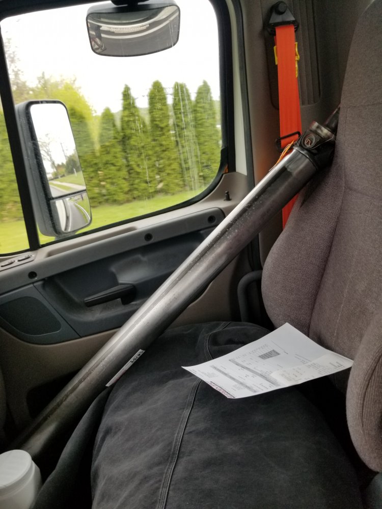

I had to get one made for my 90 single cab regular bed.
51871
I used 1650 series u joints for more strength. Not necessarily needed but I plan on making alot mor power at some point.

You couldn't get your stock drive shaft to work?
Mine stock one is real close.maybe an inch to long but I haven't cut hole in floor yet or bolted anything to it's permanent spot either.it ll be close that's for sure.need to replace slip yoke also to change it to 28 spline since mine is 25.
