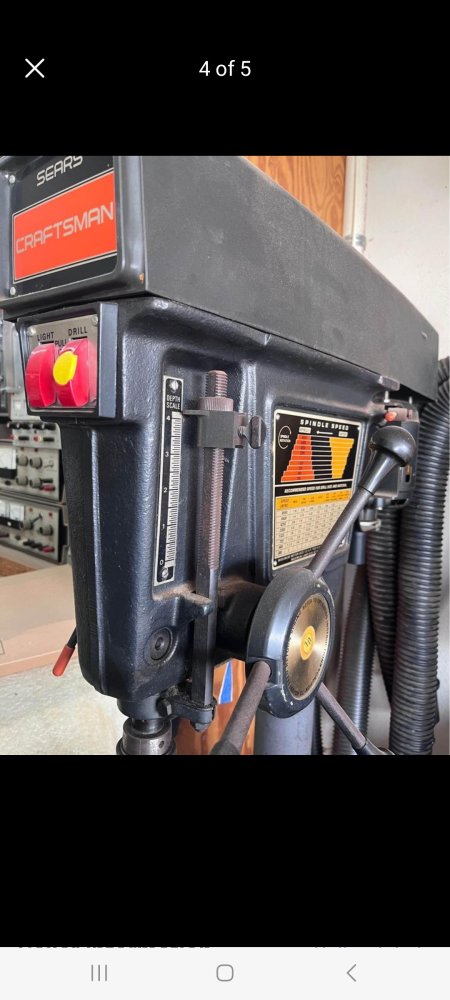

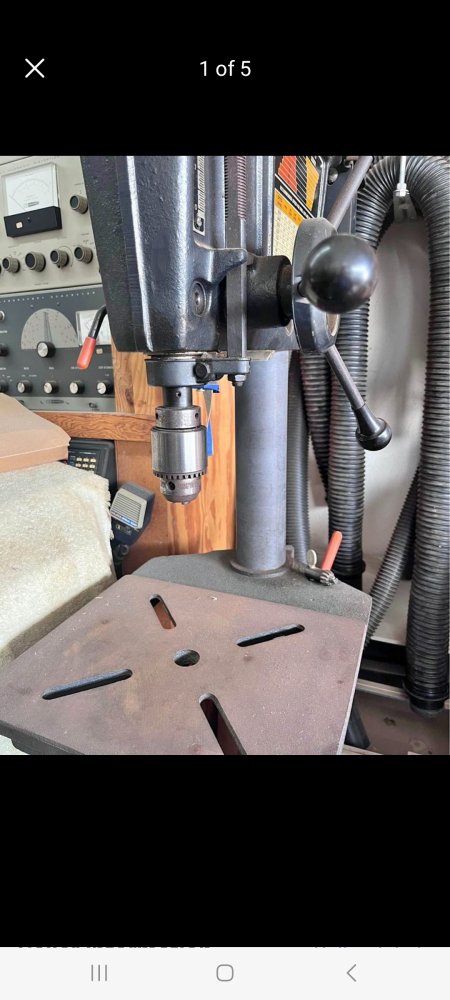

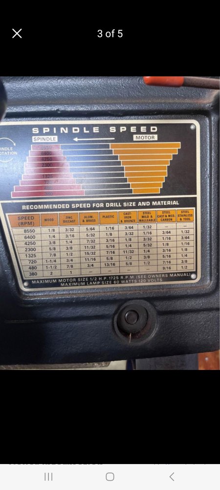

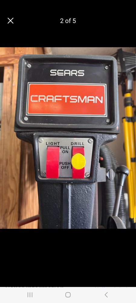

Check this one out:
That looks like a late 70’s / early 80’s model. They were probably the last of the good ones.
That's the shame about it, at least a lot of it. Can't get parts for them, and in a lot of configurations no other part will suffice.

Check this one out:
I
That looks pretty decent. If the price is right, it will do a lot of work for you.
I tend to gravitate toward a machine geared toward more industrial use. But not everyone needs that. As mentioned, getting a decent vice to use in it is important. But the vice needs to be bolted down. Anything you’re drilling needs to be clamped firmly to the table for safety. It’s good to also have a good clamp set - step blocks, T-bolts, etc. I’ll try to get some pictures of my setup tonight or tomorrow to show you a few things. Mine isn’t perfect. But it works well. I have an Enco tabletop machine rated for at least 3/4” capacity.
Look for 3 pulleys on top. Makes it much easier to get a good speed for metal. Tho the one you posted just above looks good.
