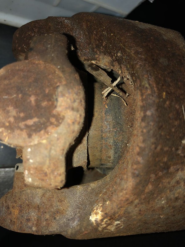

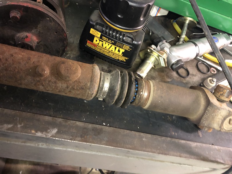

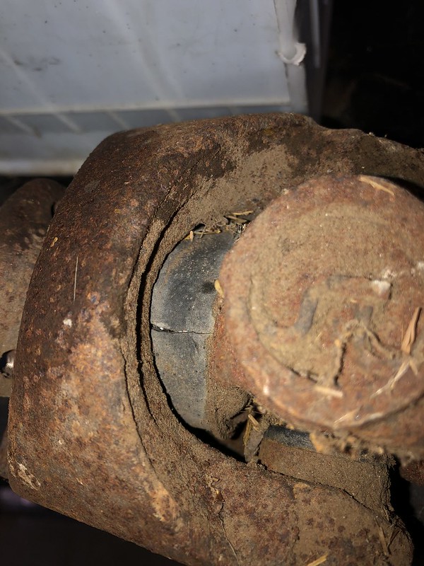

Front driveshaft out of a '95 Ranger. Been planning on using it for my '85 mutant. I got it cleaned up today and noticed the ball socket is drier than a popcorn fart and the boot is cracked. Is there a way to grease these things? It feels smooth and tight but is it long for this world (aka worth having shortened and rebalanced?)
I am very tempted to shelve it and just get a regular shaft with a cross on each end...

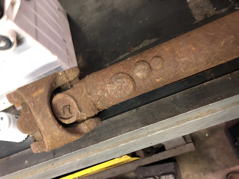

Doesn't look like it balanced very well for Ford either:

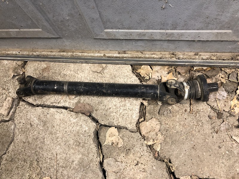

The factory driveshaft I took out of the truck just had two crosses.
I really have never had any complaints with it other than it having a slip yoke for the t-case which will not work with my current t-case.

I had one of those checked & rebalanced at a local driveline shop... Mine too had that center seal boot cracked. They said it was a non-issue because other seals already seal around the ball and the centering pin (which are not visible if the joint is assembled).
I ran with it, and so far it's been OK (this was about 6 years and 30K very dusty miles ago).
IMO, if you have a lot of angle on the front joint at the t-case, stick with the double-cardan style. As mentioned earlier, a single-cardan joint isn't near as smooth at the same angles as a double-cardan would be.

All the later TTB (second gen and newer) RBV's I crawled under had the double cardian shaft. Every one of them had a cracked boot. Some had visible grease around the boot and some didn't.

This is what my truck left the factory with:
