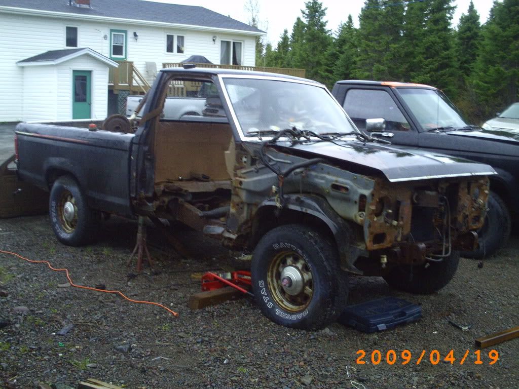

Removable doors are the way to go. It is a very easy mod on a lot of RBVs, I did it to my '86, a buddy's B2, and a couple others. You take the fenders off, then one hinge at a time, leaving the door closed. Drill the pin out of the hinge and replace it with a hitch pin, put the hinge back on, and repeat. You leave the doors shut so they stay lined up.

Hey BONES was it hard to cut the doors like that? What about opening them? I like those a-lot!!
Wasn't hard to cut at all, I drilled out all the rivets holding the window mechanism on as well as pulled the bolts associated with it and then marked and cut the door. I started with the arm rest placement and measured to cut just below the arm rest, figured that was a good height to cut the door down to. I marked it from the front window opening down to just below the lower mirror bolt holes on the big chrome mirrors and then drew a line across the door up to where to door handle is, then a line up just past the out side door handle to line up with the back of the window. I used a wd40 can for the round cuts at each bottom cut, used a combo of jig saw and zip cut on the 4.5" grinder.
Door handle is on the inside only and easily accessible from outside.
