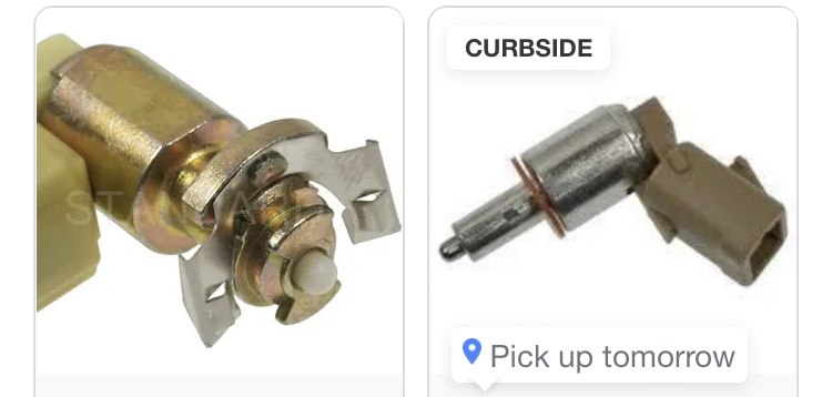

Hello! I have a 1995 Ford ranger. It does not have automatic locks. I’m trying to fix my door ajar light problem and in the process I found that my drivers side door latch has two switches- one is the door ajar switch, the other is a mystery. I can’t find any info online about what it could be. Does anyone know what the second switch is for? The door ajar switch looks like the one on the right, the mystery switch looks like the one on the left.

right thanks, yea there’s plenty of threads about the light issue, but I only found one thread from 2004 asking about what the second switch does and it’s unanswered. The mystery switch does not affect the door lights like the door ajar switch does. I put a meter on the terminals and one side is grounded, the other side was grounded and then momentarily not grounded, periodically with about a 1 second frequency, with the car off. I thought this was strange. It must be going to some system monitoring it even with the car off, but I don’t know what.
I figured it out. It’s a component of the anti theft system. It must be there to sense if the door is locked.
Hopefully this will help someone else wondering the same thing down the line.
Thanks for posting... I recently took my latch out and cleaned everything and couldn't figure that out either.
