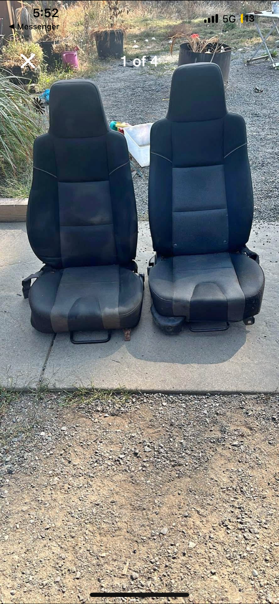

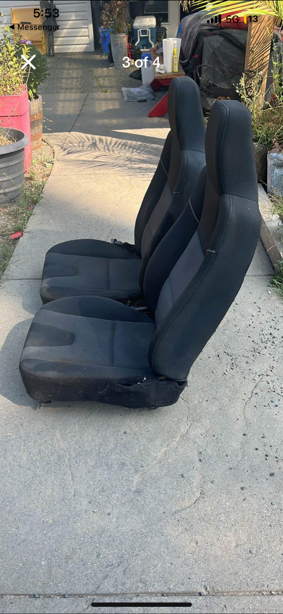

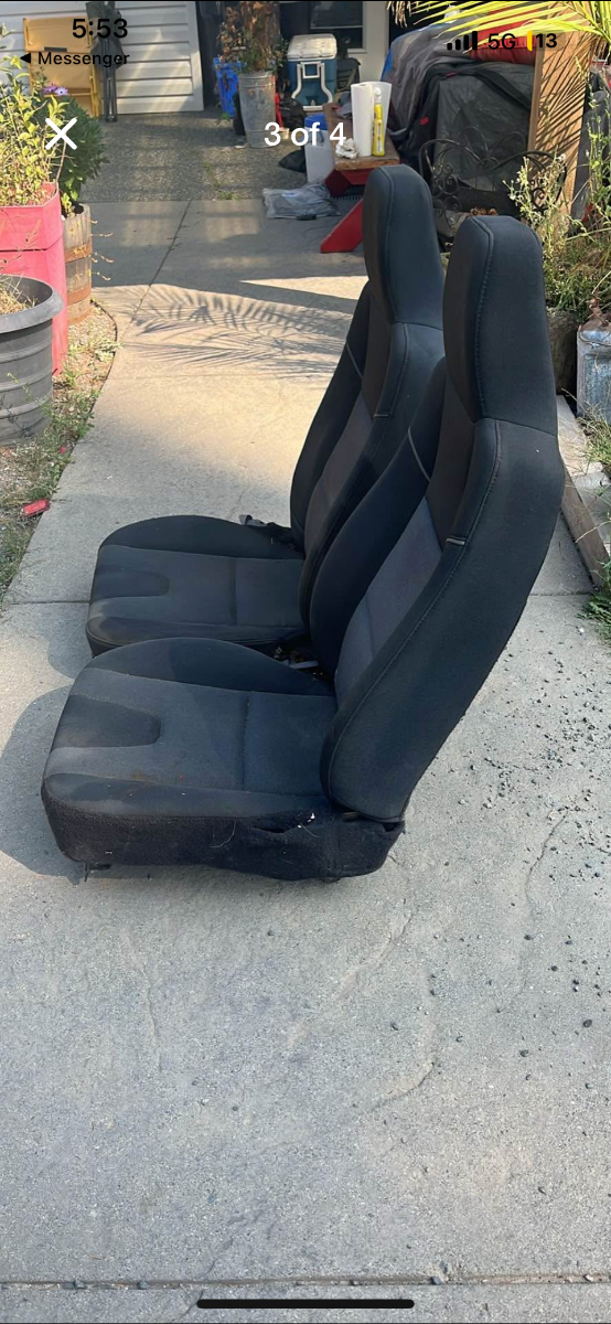

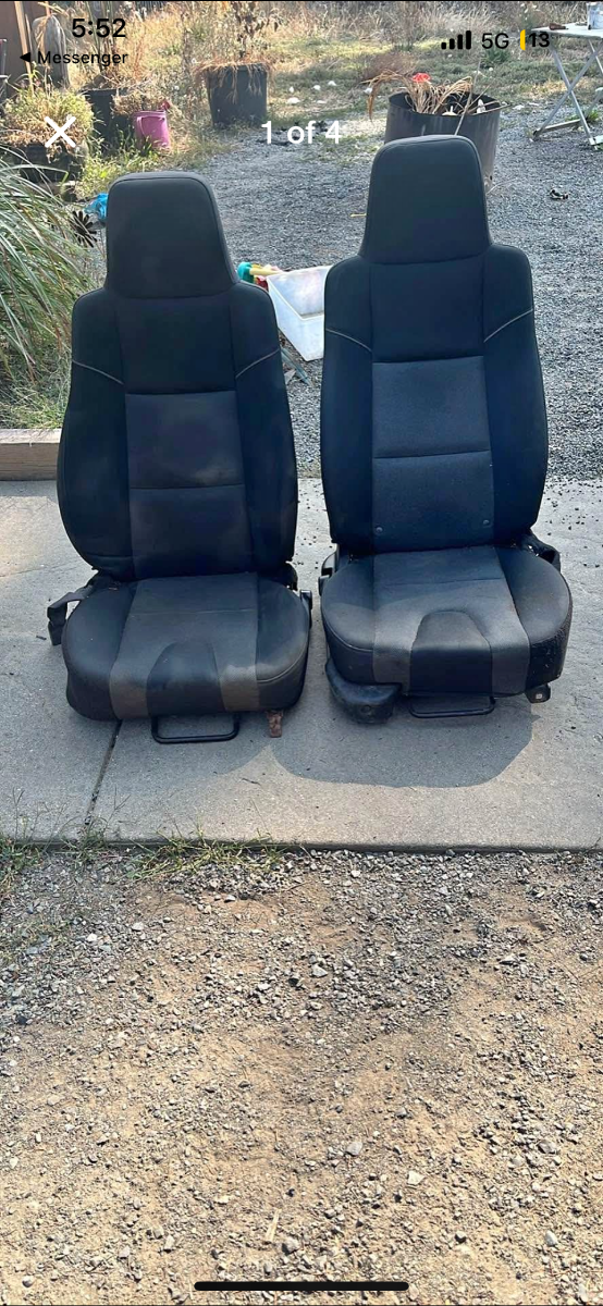

Hello all,
couldn't find anything asking specifically what years of vehicles with leather seats will bolt into a 98 ranger SPLASH edition with 4X4 extended cab. Id prefer to get rid of the stock 60/40 seats which have driver and console attached and passenger seat mounted seperate.
also I have some sport seats available which look like they aren't from any specific vehicle. was wondering if anyone knows the specific dimensions of the passenger and driver side mounts? and I could just bolt it right in without any alterations required? thanks again for the help.

Hey thanks for the tips, I checked all rangers and b series, and explorers as well. Literally every single one had seats removed. They are obviously in very high demand. I’m thinking option two is mount different seats onto the old tracks. I found a 98 4Runner with seats of similar dimensions, but I know for a fact the mount holes won’t line up, but how difficult would it be to create a new mount location on the underside of the 4Runner seats? Any tips? Thanks.

Best bet would be to take one seat out at a time and make a template off the Ranger seat out of cardboard and see where the bolt holes line up compared to the yota seats... might be as simple as redrilling one or the other or more complicated like a big sheet of 1/8" plate...
