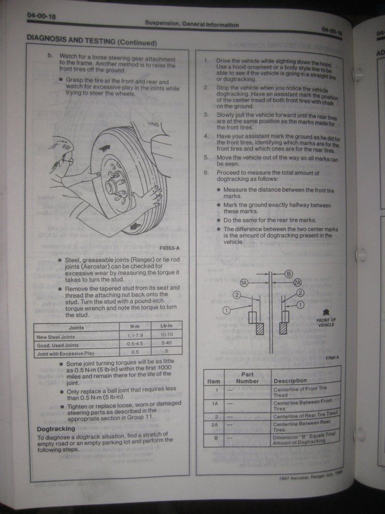

The shop manual has a way to test, get the vehicle going straight by lining up something on the hood with a point, mark on the ground where is center tread of front tires, then drive forward (straight) and measure where back centers are and measure the difference that's the amount of dogtracking, for mine the spec is 18mm (less than 3/4") per side so it's 1.5" total, not per side as I'd said earlier.
They're saying if the road is crowned a lot, you might notice the front seeming higher and that's why. I guess they mean higher relative to the rear, since crowned road always makes the truck tilt. I think that would be hard to notice.
So they tell you how to measure it but I don't yet see anything about how to adjust it, if it were off. I would think it would have to be done with spacers?
Certainly when shops check alignment they have to go by the specs.

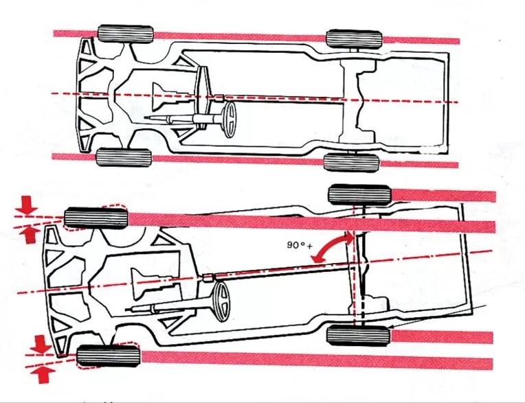

When driving in a straight line the track of the rear wheels will normally be narrower than the front. Dog tracking referrs to when the rear track is offset from the front. See picture below that I stole from somewhere online, also this youtube video showing what it would look like driving down the road.
Generally this would be caused by the rear axle being out of alignment with the vehicle as in the image above. Correcting it would require fixing what ever is causing the axle to be out of alignment, then doing a full alignment.
Now if the vehicle looks like it is driving straight down the road and still has the tracks offset, it is possible that the axle is physically offset to one side. Don;t ask me how one would accomplish that, but I've heard of it happening on a solid axle truck before. Most logical explination I cangive would be custom axle with the spring perches located wrong. How ever it was accomplished, fixing would entail the same thing.
The road being steeply crowned is going to cause the vehicle to pull to the side. Correcting for this pull may appear as dog tracking, but it isn't. That's why you chould be checking on a flat level surface, like a parking lot, not on a crowned surface like the road.
Shops do go by specifications when doing alignments. Typically when you ask for an alignment they are going to adjust the front wheels to be in specification in relation to the rear wheels. If the rear is out of spec (or the chassisis off) everything will be off, but the wheels may still show in alignment.
I was just quoting from the manual (bolded part).
Unless I'm misunderstanding it, they are expecting that you understand that dog tracking is crab-like behavior and it (truck) should -not- be dog tracking.

So here's what the manual says. I think they just expect that you just know, dog tracking, it's bad (because... I dunno... it looks weird? drives weird?), you don't want it. Note they say on a crowned road it may appear (!) to dog track but my take is they're just warning you, this doesn't mean it's dog tracking (out-of-spec) it just appears that way, but here's how you check it.
oh and I have I re-correct myself my track should be 1.5" narrower on each side so 3" total. (Dana 35). The truck is straight along the side that's why you see the rears quite far inside the fenders, front, not so. They didn't make any attempt to hide it in the body shape, on this vehicle.
It's the second column of the last pic where they talk about how to measure it. "when you notice the vehicle dogtracking" - um... how do you notice this? the body is crooked relative to your straight line, is how I take it.

so they are saying in the test, pick points you can line up and drive straight then look at the truck. is it straight or angled? if it's angled it's dogtracking and you can measure it and find out why (and fix it)
