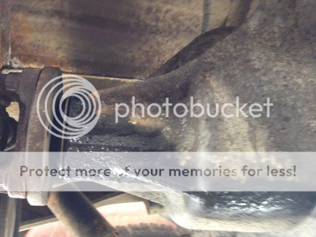

hi,
I just had a service done and they didn't mention this. I just happened to look under my 2011 ford ranger and was wondering if this looked normal. Mileage is approximately 100,000 km. And the truck is driving fine. Is there an easy way to upload an image?

Hope this works. sorry for the trouble. My friend said made a yoke seal?
Differential Pinion Seal. (Yoke seal would also get the point across)
A little seepage isn't that big a deal. Just check the fluid on a timely basis. That's a bit on the heavier side however.
Tricky to replace. Pinion nut has to come off, yoke next....Then the seal. Had one done on my (former) company mini-van. Pepboys wound up causing $650 in damage to the rear end. Normally the seal replacement is simple, but setting the bearing preload, possible crush sleeve replacement...etc.. That's where the fun can begin.
I'll let others more knowledgeable then I am to respond. That's just my 2 cents.
S-
Thanks for the quick response. I'm getting my winter tires off in a couple weeks, I will get the mechanic to take a look then.
yes, that worked :)
I would clean it off, degreaser and wire brush, check the level in differential as well.
Then drive it a while to see how much it is leaking
It is most likely a current leak but you never know
Keep an eye on the level, will probably need to take it in and have a pro fix it.
Those are easy to fix, use a chisel to mark a line across the bolt and nut (that way when you put the nut back on, you tighten it down so that the mark lines up and is torqued down pretty dang close to where it was before.) Zip the nut off, old seal out, new seal in, reassemble pinion flange. Done.
Hi,
I got the pinion seal replaced yesterday at my mechanics. This morning there is some new oil in the same area. Is this normal?

It is common for the area to be wet after a seal replacement. Degrease and power wash it off and drive it a few days. If the wet comes back, take it back to be redone
