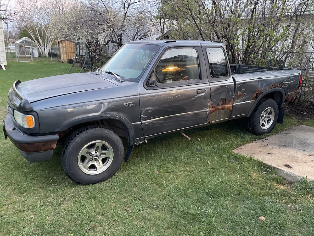

As I said it's a '94 B4000 - not the old square body Mazda style, it is the Ranger style truck. I know the fenders, hood & everything won't work individually, found that out the hard way years ago... I just don't recall if the doors were different.
Yes, that is a HUGE hole rusted through the side of the cab behind the door........ :poop:
Shit son that aint bad at all
