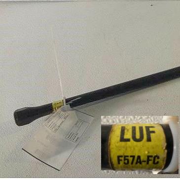

You will need to look at the codes on the sticker on the door jam. There is information on how to read the codes in the tech library. For the torsion bars, there will be a code stamped on the end that pokes through the lower control arm to compare with. My guess is your OEM torsion bar would be a B

I solved it with 31" tires. It's not so rough now and I knew what I was getting into. So, no complaints. I just want to make sure others who want to do it know what they are getting into before hand. Stock 29" tires with #1 bars and 1750# springs is getting into chassis suspension territory. Though, I imagine they will still have a rougher ride unloaded than my truck does.
