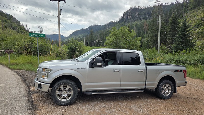

Having more mirror is nice day to day, its nice to keep track of what your trailer is doing and I have even used them to watch tires for vibrations at speed. Also... I pull a lot of weird crap. (non tow mirror pictured)
