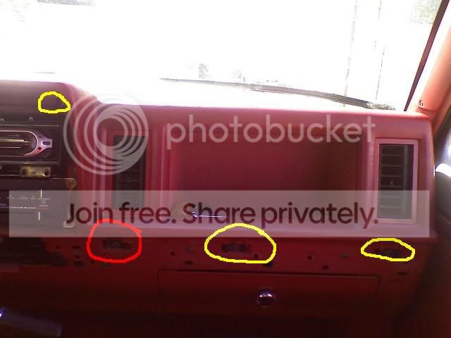

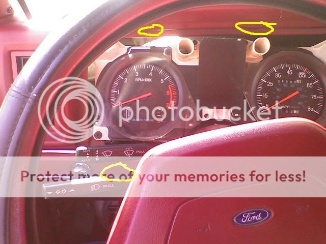

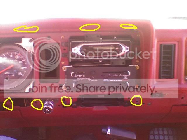

yellow is a removed screw
red is a stripped screw
and i still have one in the dash(metal piece) that spins, but won't come out
the front dash piece is pretty loose, like you can see i only have one screw left, and it's pretty god damn well stripped.. i have a feeling this was from when my sister was dating "a really good handyman", and she had him put the deck in my truck for my birthday last year.. without me knowing. cuz the screw was like that when i got in there
btw, the screw locations may be partially off... but like i said.. i think me and new speakers is only
stripped screw left in front dash piece
spinning screw left in metal dash piece
2 on grill cover
3 on right dash speaker
I WANT NEW SPEAKERSSSSS
