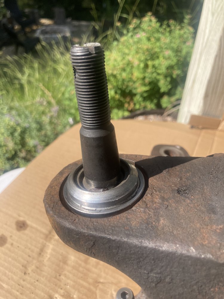

I’ve got all my old ball joints out and all my new ball joints loaded in.
All seems great except for the fact that one of the upper ball joints sits just slightly too shallow for me to get the snap ring inside the lip.
I would need to hammer / press the ball joint out, and grind down some of the bulk material from the knuckle.
1. Can i re-use the same ball joint if I hammer it out? I don’t think I’ll be able to use the press kit to remove this sized ball joint.
2. How unsafe is it to just omit the snap ring?
I think maybe this knuckle ended up with more material around the ball joint than the other knuckle. The snap ring on the other knuckle was very close to not fitting in, but it went in. This knuckle seems to have around 0.5mm-0.75mm of extra material blocking the snap ring. The ball joint is seated well, as you can see from second pic.

If you can find a socket or a short length of pipe that fits over the top part of the joint and sits on the ledge, you should be able to press it out and reuse it. It doesn't look like the joint was pressed in straight and square, that may be why you can't get the clip on. If you do need to grind a little materiall off the steering knuckle it shouldn't hurt anything but try repositioning the joint first.
