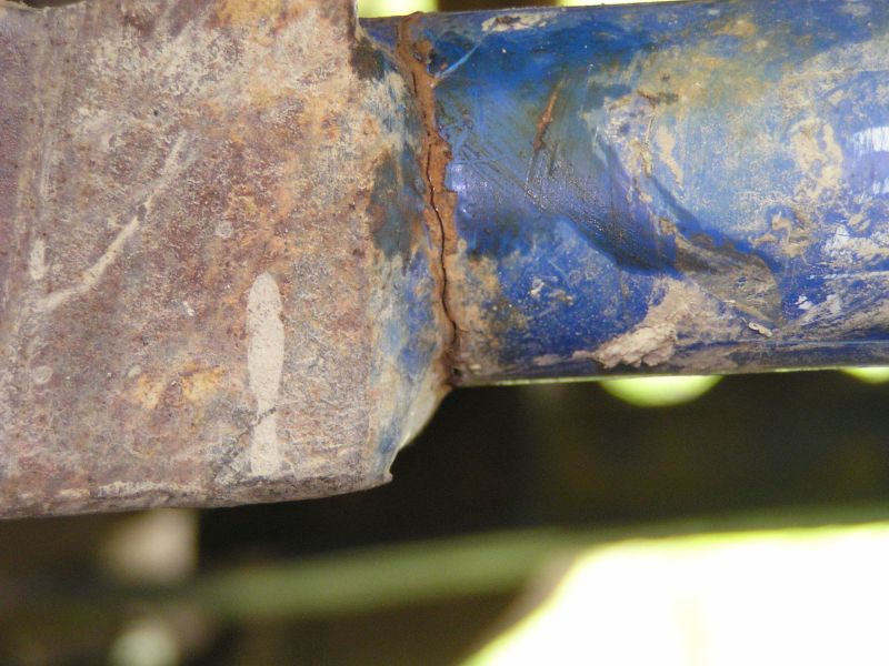

I have an old type Duff setup. I broke one of the arms. They look much stronger than the Skyjacker arm up at the ears, but they are maybe too heavy up there and not designed well at the point they transition to the tubes, making a hard spot. It comes down to shit happens.
attachment.php
Weld it up stronger and keep going.

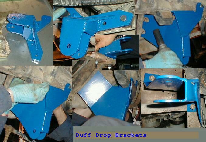

The Duff drop brackets are excellent, but only come in 3".
Not now they don't. You can get 3" or 6" brackets; and you can run up to 2" more lift with the 3" brackets and still get aligned.

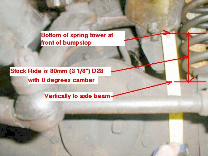

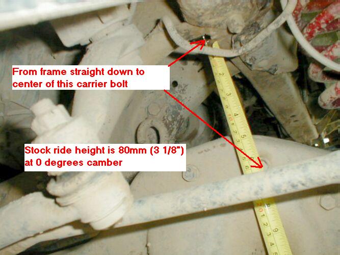

This is how the ride height is measured. If you have 3" lift brackets you should shim your coils to acheive 3" more than this measurement, for example. Until you have experience with it, I wouldn't color too far out of the lines. Top is D35 and bottom is D28.
