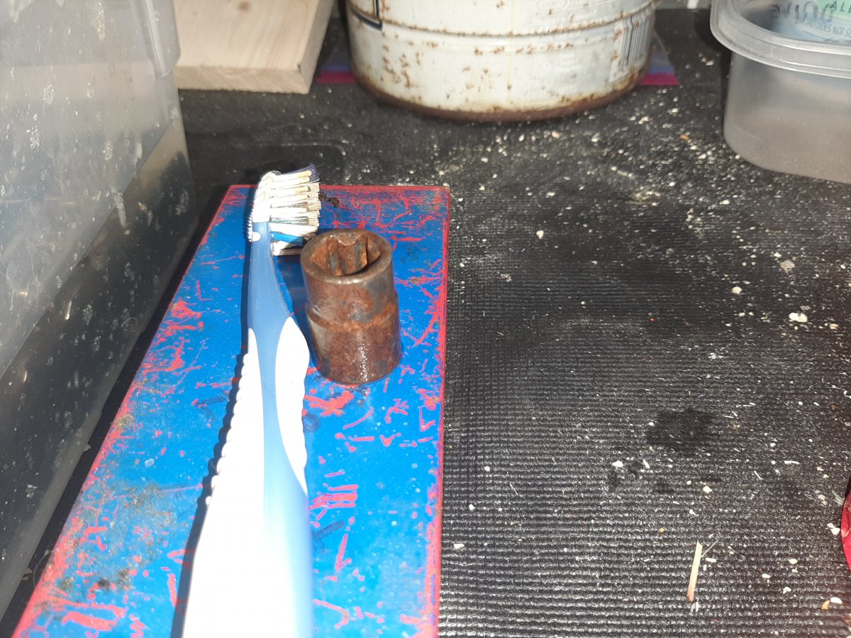

I'm cleaning all my old junk tools and trying to find the easiest method to get rid of rust. So far I've got about 100 sockets soaking in vinegar and have a ton more sockets, wrenches, pliers etc. Simply cleaning them all by hand with a wire brush or sandpaper is just too much work.

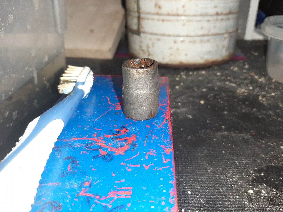

Vinegar isn't doing too bad so far. Only been a couple hours.
You can fool the smart charger by putting a battery in the circuit.
And vinager works just fine if you're patient and doing small stuff.

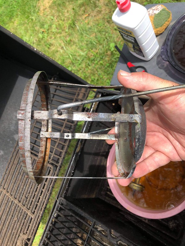

Evaporust works wonders on my lantern stuff.
I used that stuff once. To be perfectly honest I found it only marginally more effective than vinegar. :dunno:
