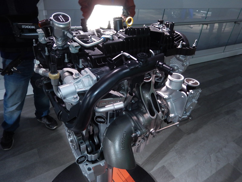

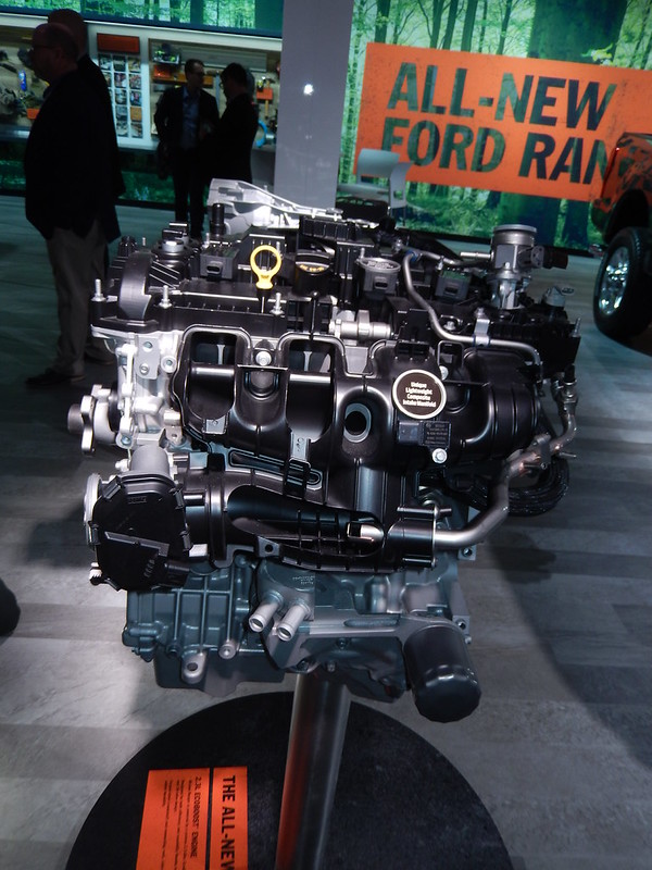

Initial impressions just looking at the Ranger 2.3 are pretty good. I like that the exhaust manifold is cast into the head. Intake is just slapped on the side like a Model T. Spark plugs/coils are in a row down the middle of the valve cover. There is a flap in the DS inner fender for oil filter access which is less than ideal but not a huge deal.
We are getting a Bronco and I am strongly leaning towards a 2.3 over the available 2.7 for those reasons.
Change the oil often, use good oil and consider a PVC catchcan if you do a lot of city driving and they do pretty good.

Oil changes aren't that bad. Getting at the oil filter is a little bit of an inconvenience but not horrible and you don't have to remove the tire as originally reported. It makes it easier but it isn't a requirement.
Removing the skid plates aren't bad either. Some thought went into to them. Loosen the middle set of bolts that hold the front skid plate and skid plate for the oil pan and remove the back bolts for the oil pan skid plate. The oil pan skid plate slides right out from under the front skid plate.
The brakes aren't anything special. The fronts are like anything you've seen before pretty much. The back brakes are a little funky since there is a cable operated lever arm to engage the pistons for the parking brake. The only hang up, but it is a design other vehicles use, is the rotating piston for the rear brakes. Tools are easy enough to get for that and aren't overly expensive. Otherwise the brakes aren't bad to work on. Just a little different from what I'm used to.
Overall engine access in the truck? Again, I haven't done much but it looks like it's no better or worse to work on than my 2011 with the 4.0 SOHC. Some things will be easy to get at and others will be a pain. I've worked on worse and I've worked on better. Considering the extra plumbing with the turbo in there, it isn't bad, or at least it doesn't appear to be.

It is based on the 2.3 Duratec that first graced the Ranger in the 00's.
They changed stuff, I don't know what exactly but it isn't just a turbo kit on a old 2.3.
AFAIK PCV carbon buildup on the valves is the only real common issue with the Ranger 2.3. It is somewhat drivecycle dependant too, in my area (lots of highway driving) it is pretty much unheard of.
The earlier varients like in a Focus had headgasket issues but they fixed that before the Ranger came out (Ranger uses a different block and I think head too)
