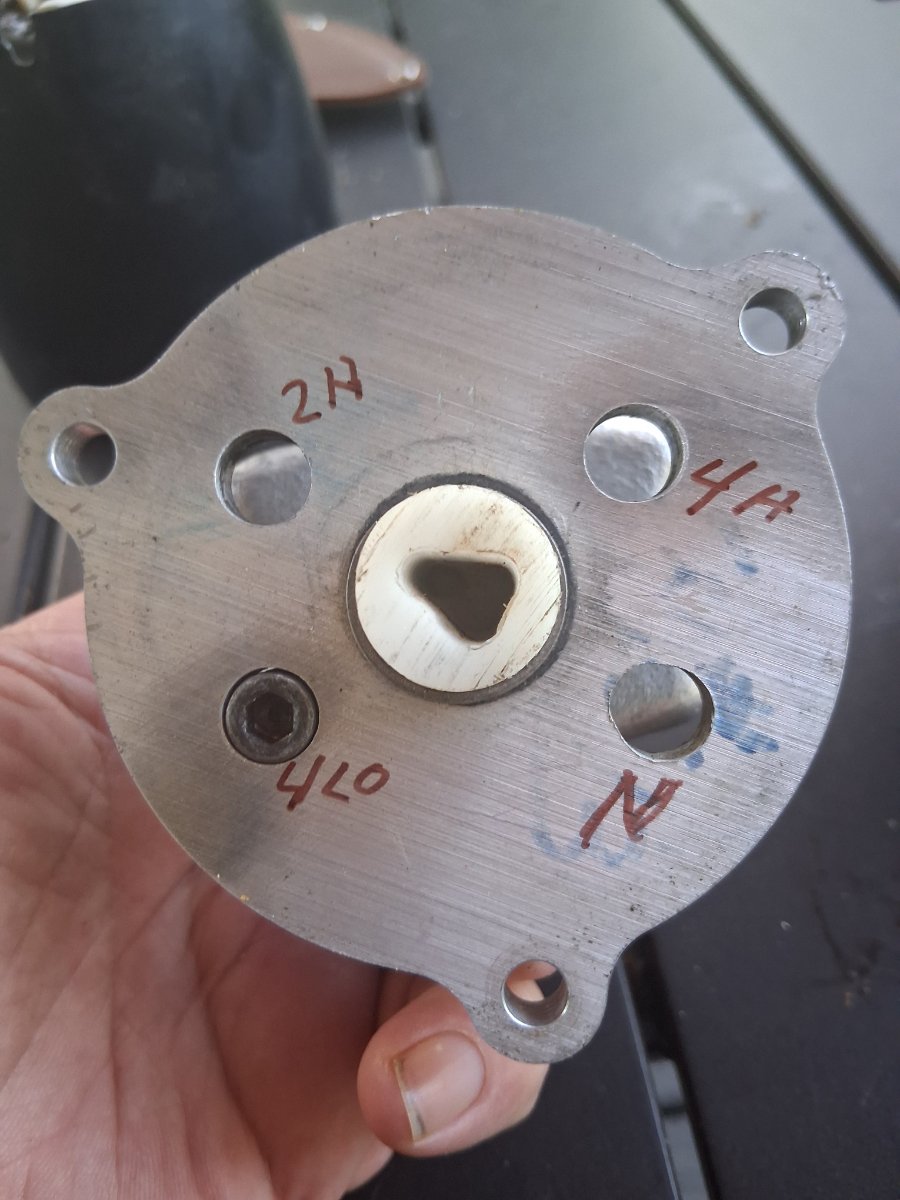

I made my own neutral detente in a Shifster. Iirc it was exactly half way between 4hi and 4lo.
I bought two used Shiftsters over the past year and a half... Just dumb luck in finding them. Sold one to a member and kept the other for my trail tool box.
Looks like neutral was added to this one and I haven't verified it. Seems like I remember the fella I got it from said it came that way from Shiftster.
photo for reference...

The one I sold... wasn't indexed for Neutral.

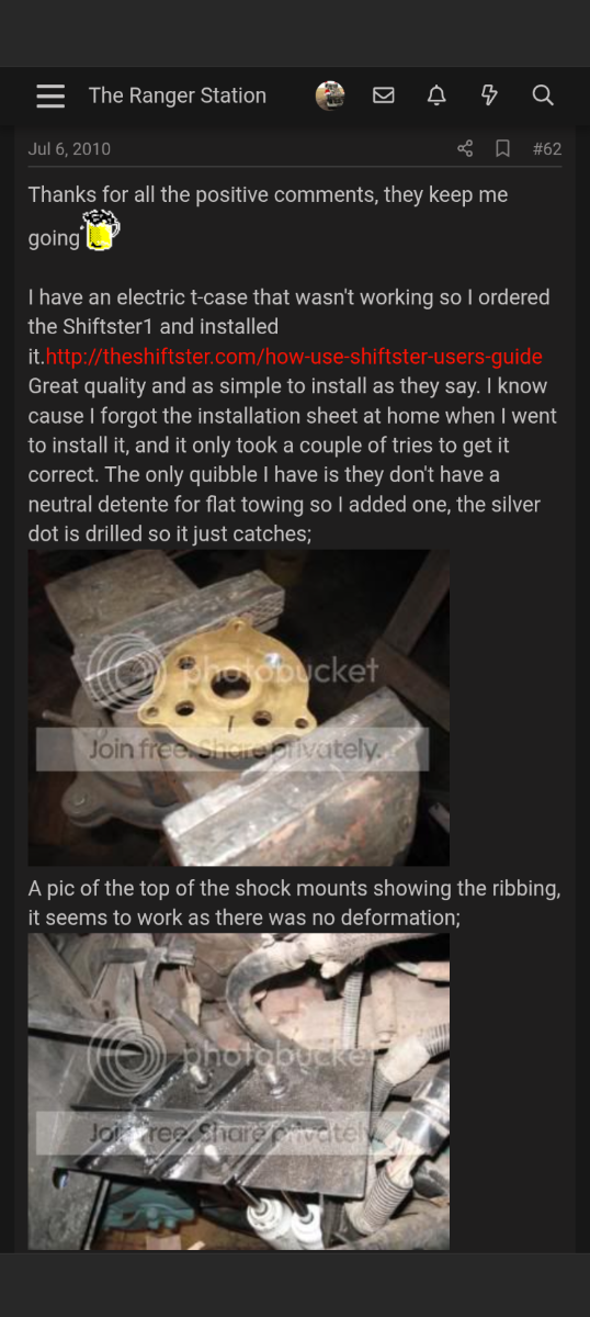

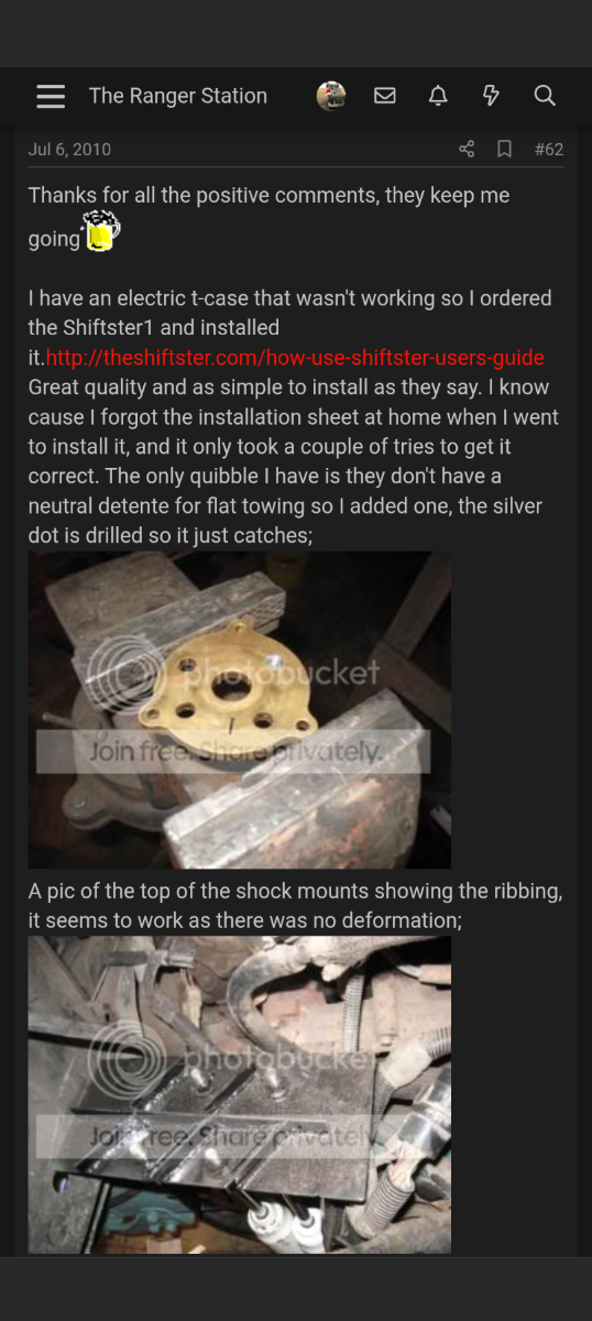

Only pic I could find of mine. Post 62 of my off-road low buck race truck.
@PetroleumJunkie412
I went under my truck to take a pic and it's gone. I can't remember taking it off. Maybe I sold it? If I find it I'll let you know.
