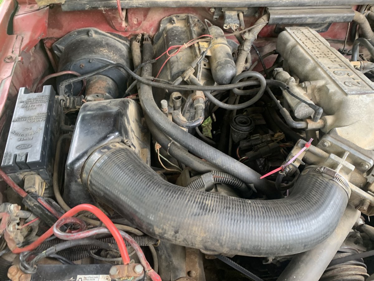

No pressure tester. Need to do the codes I guess. definitely will show o2 sensor. But that won’t make It undrivable. Just miss and bad fuel mileage. Think this first started after a plastic vacuum line broke a couple times. Went to little black canister on firewall between the AC fan and engine
Thats the MAP sensor line.
Its pretty important.
The MAP tells the ECM the amount of vaccuum in the intake so it can meter fuel correctly.
If its leaking or collapseing that could be the issue
The line going to the canister under the MAP

I think its just a vacuum resivor
When it was acting up this last time. I disconnected the MAP and it started doing a little better. Believe I need to do the rest of the freeze plugs as soon as possible. Starting to leak a little on one of em. Put another module on the new distributor. No more acting like a rev limiter. Cleaned the tank. Again. New pump sock. New inline filter. Cleaned IAC . Started cleaning the throttle body.. cleaned ground connections.. checked most all plug connections. Checked throttle position sensor, need to do again. Battery wasn’t fully charged. And my old ohms meter was acting up. Was reading 4.3 constant, was falling smoothly as accelerated. Rigged up a redneck “ cold air “ blower on my module/distributor area.
