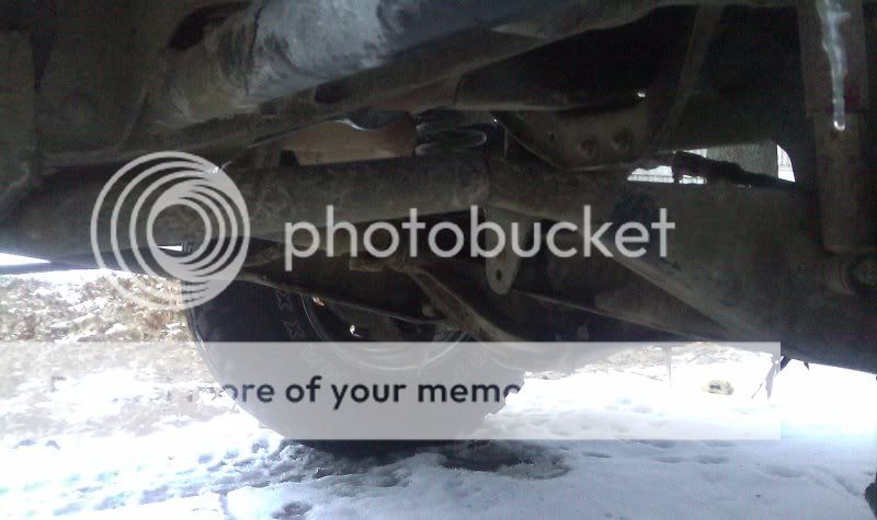

I think I found out why it has been pulling to the right ever since attempting to scale "Jay's Hill"
Ouch, if you have the factory ford jack you could put it in between the frame and the RA and bend it back...but it def needs a gusset at the top...

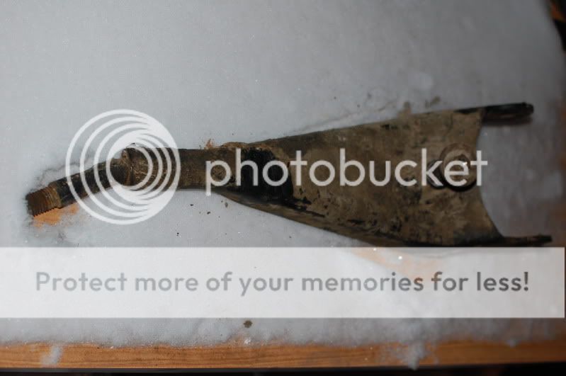

Half way through putting a D28 arm on it. Glad I pulled them off before scraping the axle.

The other side looks kinda bent too. I think it is time to gusset!
Yeah I'll be checking that one out too.
WooHoo I was for only one :thefinger:
Do you think that would of happened if they would of been welded to each other ?
I am not sure if it would have been better if they were welded or not. It may have screwed the extension itself.
D28 arm is in.
