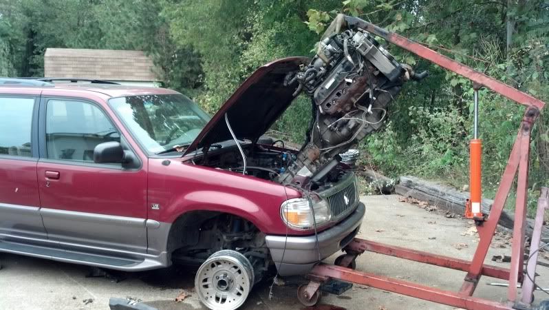

Working on pulling the motor/trans in the Mounty then selling the shell right now.

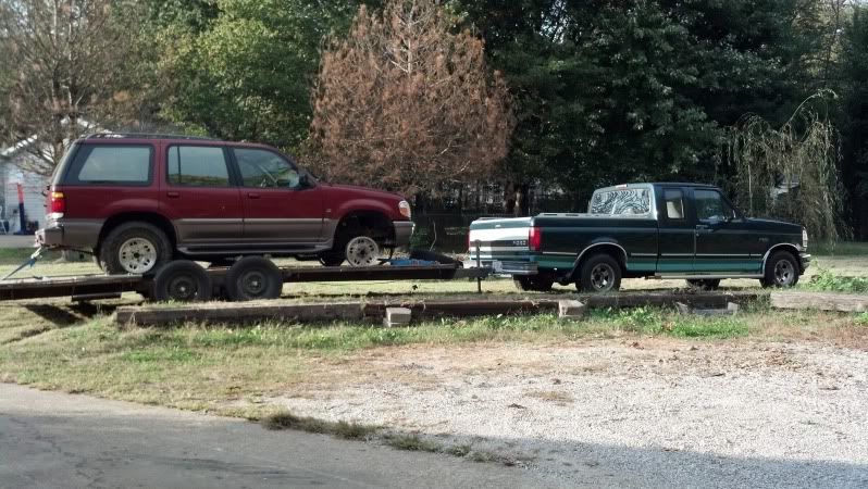

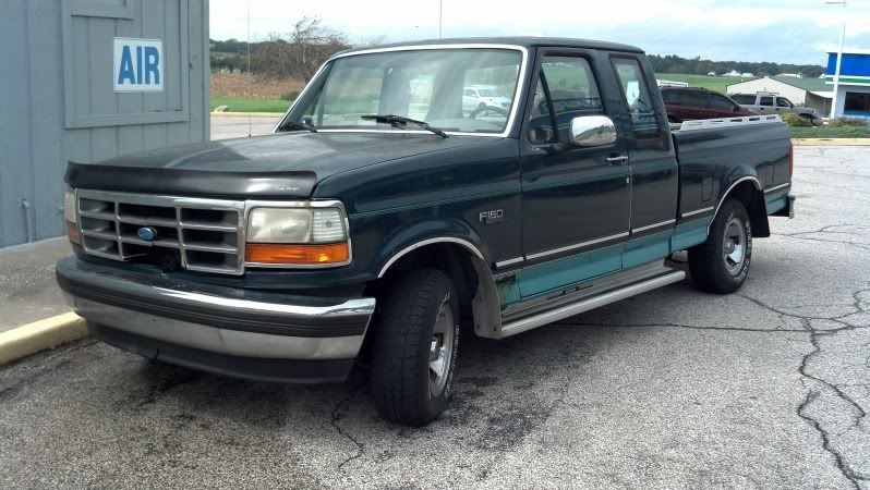

Traded my Ranger for an 94 F150.
disciplerocks's B2 build thread

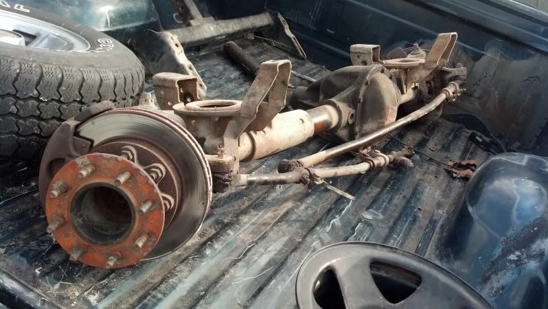

And I picked this thing up today for the B2. Will be getting a Sterling for the rear. Then the D44 and the Mounty trans will be going in the F150. AWD with lockouts.

Thats what it is. Some people say look to be sure it doesnt say d61 on it.
Sent from my rooted SPH-D710 using Tapatalk 2 now Free
Yes its a Dodge D60. No it does not say D61.
Dustin, is there another one there? I thought I remember you saying there were two...

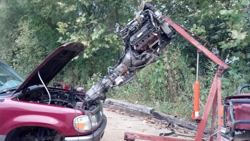

What I did today. Had a couple oops moments. I ripped the winch guide off the B2, my hoist tipped with the motor in the air and busted the oil pan open, and I blew a power steering line on the F150. But I got what I wanted to accomplish done.

This is my plan for the CAD front axle. I have seen write ups on how to make your own kit with a throttle choke cable. This way I can weld the front, save some $$, and still be able to disconnect the passenger side to help turn. And I will be able to do it from inside the cab.
http://www.4x4posi-lok.com/app_dodge.html
